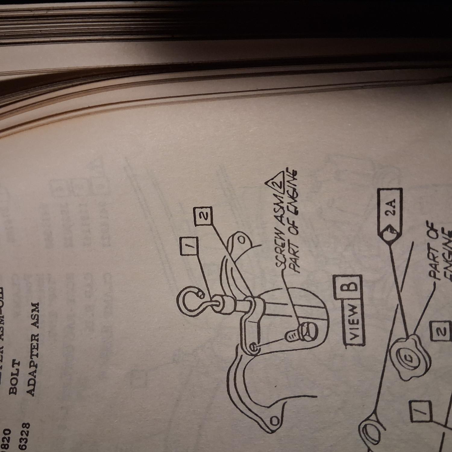

A little backup for Jeffs info.
This is from 68 Chevelle Assy book. The "part of engine" is also in other places.
Interesting to see the phosphate wiring bracket.
