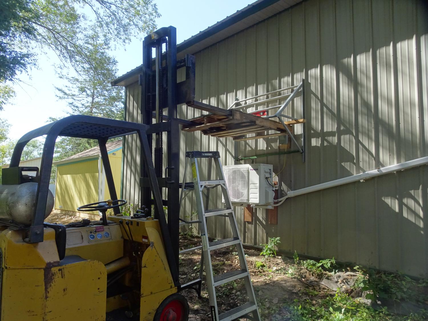

I built a heavy duty awning to deflect heavy snow when it slides off the roof.
