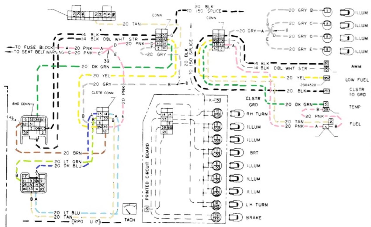

Snippet of wiring diagram (gauges and cluster). Yellow low fuel lead runs through console harness and up to the cluster plug as loct'n 952. The Low Fuel lens must replace either the OIL or TEMP warning light locations when gauges (and low fuel indicater) are added?
Would have to see a cluster to figure that out.

So yellow wire must plug into a lone bulb. Not one in the circuit board. How does that work if it takes the place of low oil light etc.

When you got gauges you didn't get the temp and oil warning lights so the yellow wire would go into the cluster plug in the spot where the sender wire for OIL or TEMP light was... printed circuit would connect to the bulb. When the circuit detects low fuel it grounds the yellow lead lighting the bulb.
That's the part I'm not sure of... where is the LOW FUEL indicator in the cluster and what spot is that on a non gauge car?
I have gauge pods in two cars that do not have low fuel lights so I'm not certain it was automatically included. I do know of one local car that had it.
