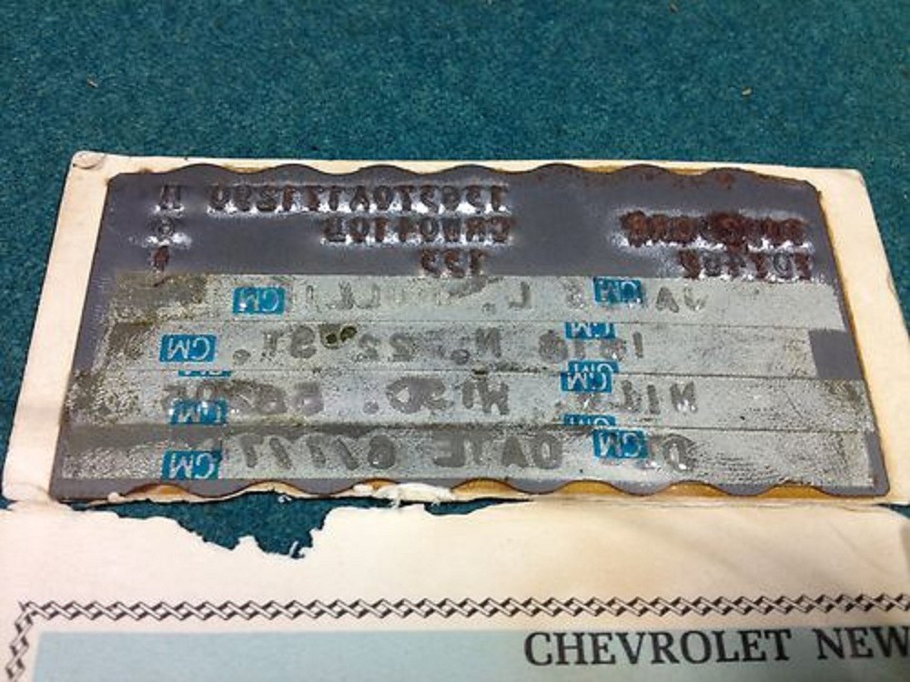

Engine code on pop looks like CRE.

Here is a look at the P-O-P
I set the photo at 200%
Second photo is inverted so we can read it a little better.
Looks to be CRR Motor which is LS6 with Auto 400 (in this car Auto on the column) T0529 is Tonawanda May 29 and CRW Rear Axle which is 4:10 posi rear Axle 0410B is April 10 Buffalo.
Auto Trans reads= 70??? 1970
Space with 133 is Manual Steering with Power brakes-Radio-Disc Brakes
H=Holley
6= June Month
P-O-P looks legit to me [img]<<GRAEMLIN_URL>>/biggthumpup.gif[/img]

POP indicates a very late delivery date. Could have been a dealer Demo....or?
