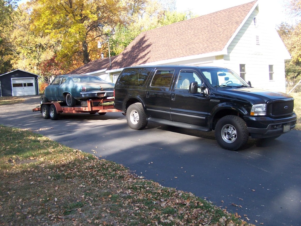

After a few months I finally picked up my "Post-Purchase".

Jim,

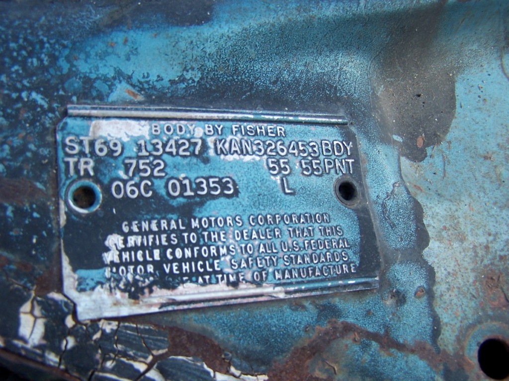

Congrats! Nice John O. 180 degree car hauling trick. Looking forward to seeing her it person. So far this is a 1 of 1, 1969 SS396 300 Deluxe Post Sedan in #55 = Azure Turquoise color. Do it right, make her all stock! This car is very rare and unique. Glad you finally got her home.

I hauled it home backwards because the front windshield is gone.

I'm not a chevelle guy is 752 Blue interior?

Code 752 is Black Vinyl Bench. The post cars were only available with 3 interior colors (black, blue, green).
All had rubber floor mats.
Drivetrain for this car is gone. there are two fuel lines so it would have been a L34 or L35 car with a manual transmission. 12-bolt, 3:31 non-posi rear.
