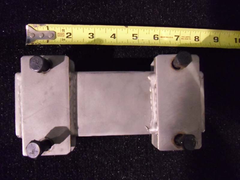

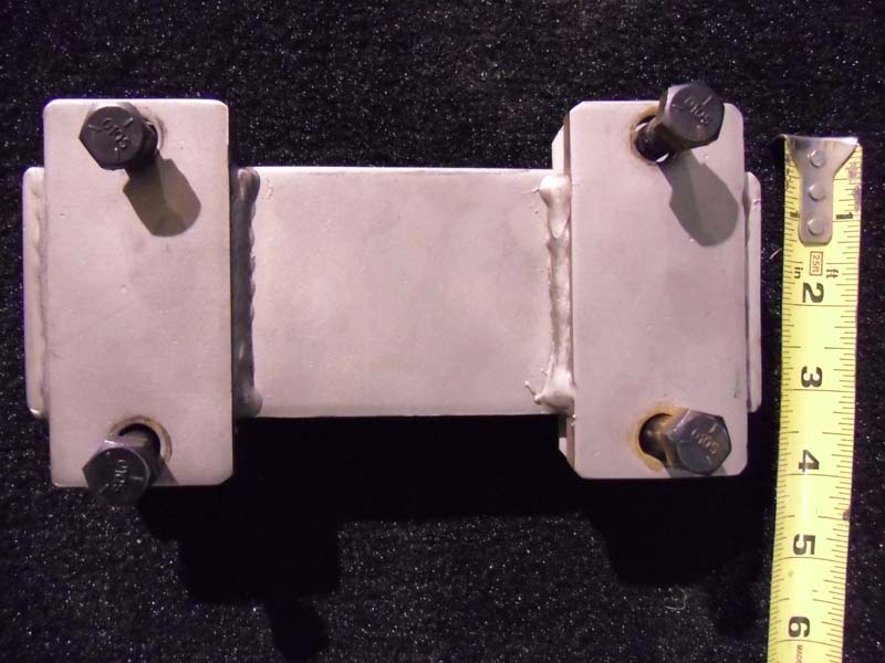

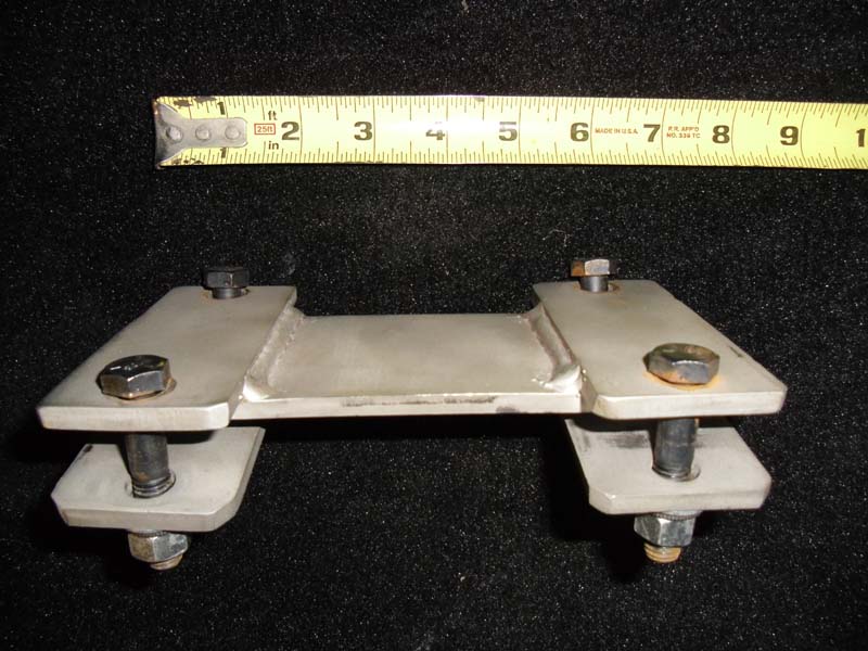

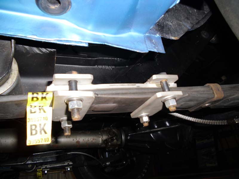

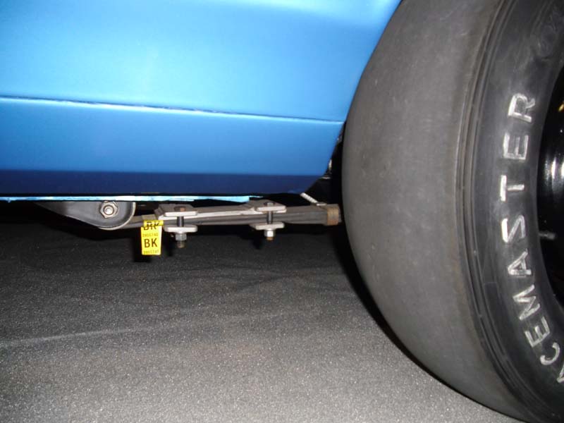

Anyway, pictures of the beautiful pieces from Big Steve, now residing on our '69 Yenko Nova...

Ok, the spring clamps look great - would love a set myself! However, you gotta scotch-brite that drive shaft, and swap out that bird cage on the left spring! What are slicks doing on that car???? [img]<<GRAEMLIN_URL>>/naughty.gif[/img]

<div class="ubbcode-block"><div class="ubbcode-header">Originally Posted By: YENKO DEUCE REGISTRY</div><div class="ubbcode-body">What are slicks doing on that car???? [img]<<GRAEMLIN_URL>>/naughty.gif[/img] </div></div>
Dressed to thrill, M...[img]<<GRAEMLIN_URL>>/naughty.gif[/img]
