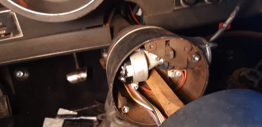

Progress forward! Brakes are serviced, new ignition switch installed, and the emergency brake assembly is back in. Last items are the windshield, trim, and all the Shaker junk to go back on under the hood. I should be driving around this weekend!
Don't you worry Big D, video of that to follow!
