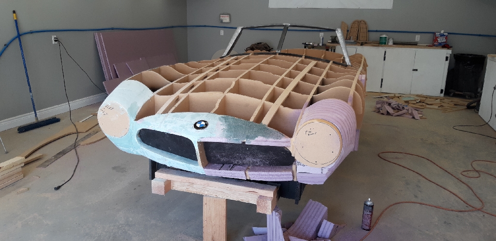

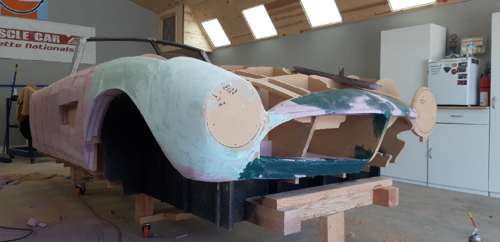

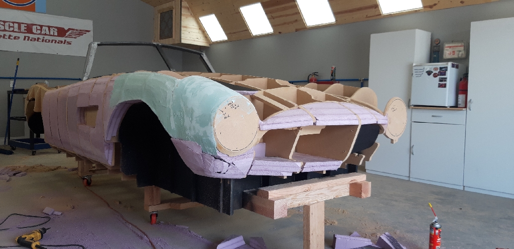

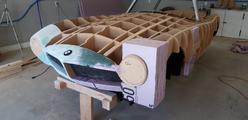

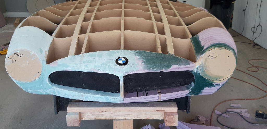

Moving forward, been doing some more sculpting and forming. This is just the initial go-around and I'll hit it with long boards after the body is foamed up. Starting to take shape! I’m extremely pleased!
Cheers
Dave
