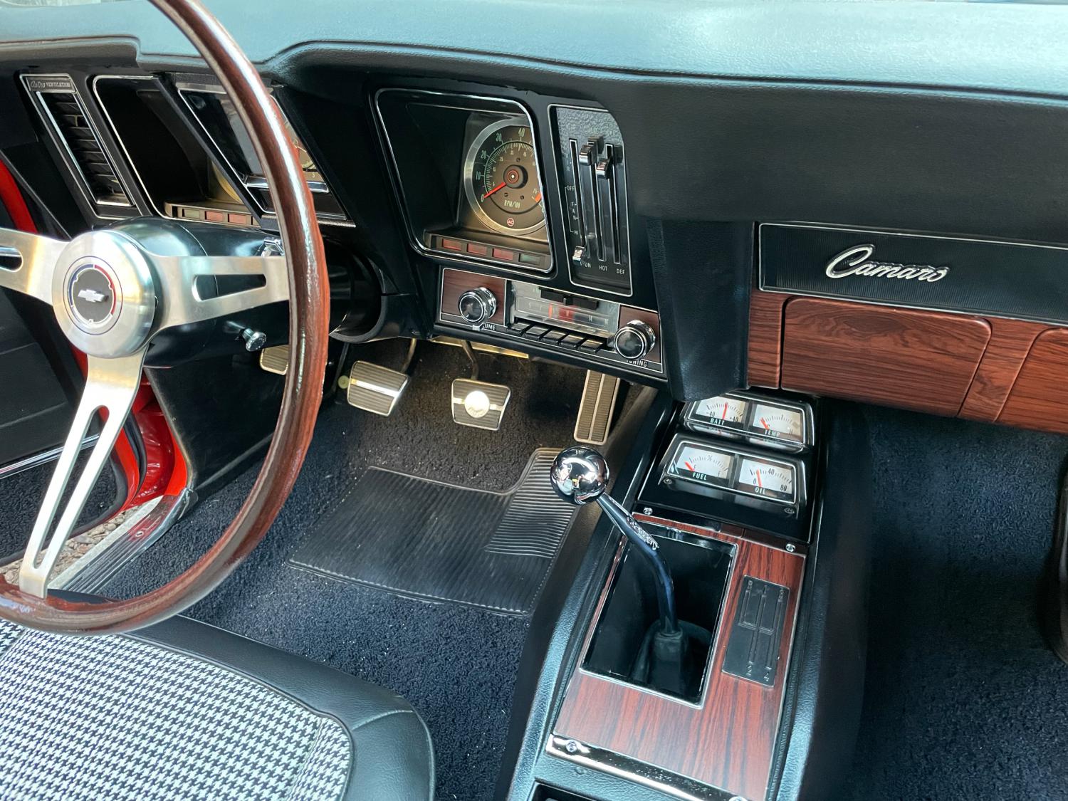

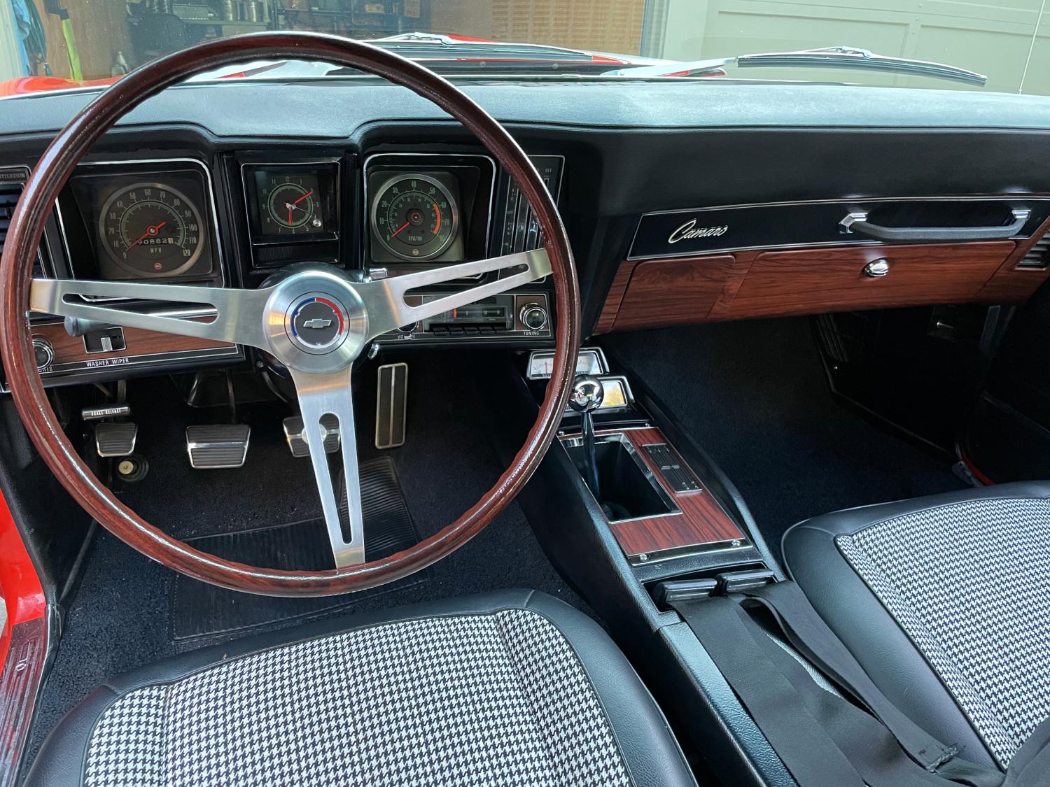

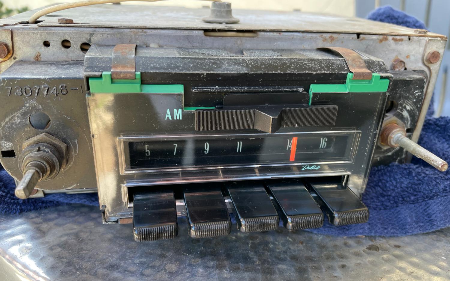

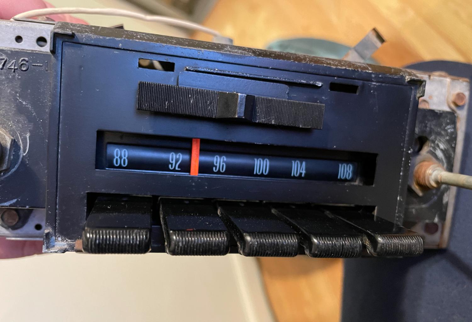

Been busy with work and life but finally finished some Camaro interior projects. Cleaned up the Delco AM/FM radio, checked the harness, and installed, but with 12V and a new speaker and antenna it doesn't yet work. At least it looks good! Until I can have a pro figure out what it needs fixed internally.
Also finally finished the woodgrain install on the passenger side with new grab handle, ashtray, and glovebox, all made by OER. Still going to tweak fitment a bit but it's pretty close, and man it just transforms the interior along with the radio woodgrain. Glad to have finally finished the deluxe interior transformation that the restoring owner started over twenty years ago. This combo in my mind is one of the great American interior designs of all time

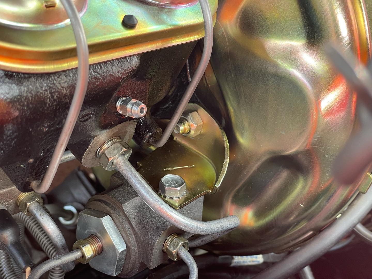

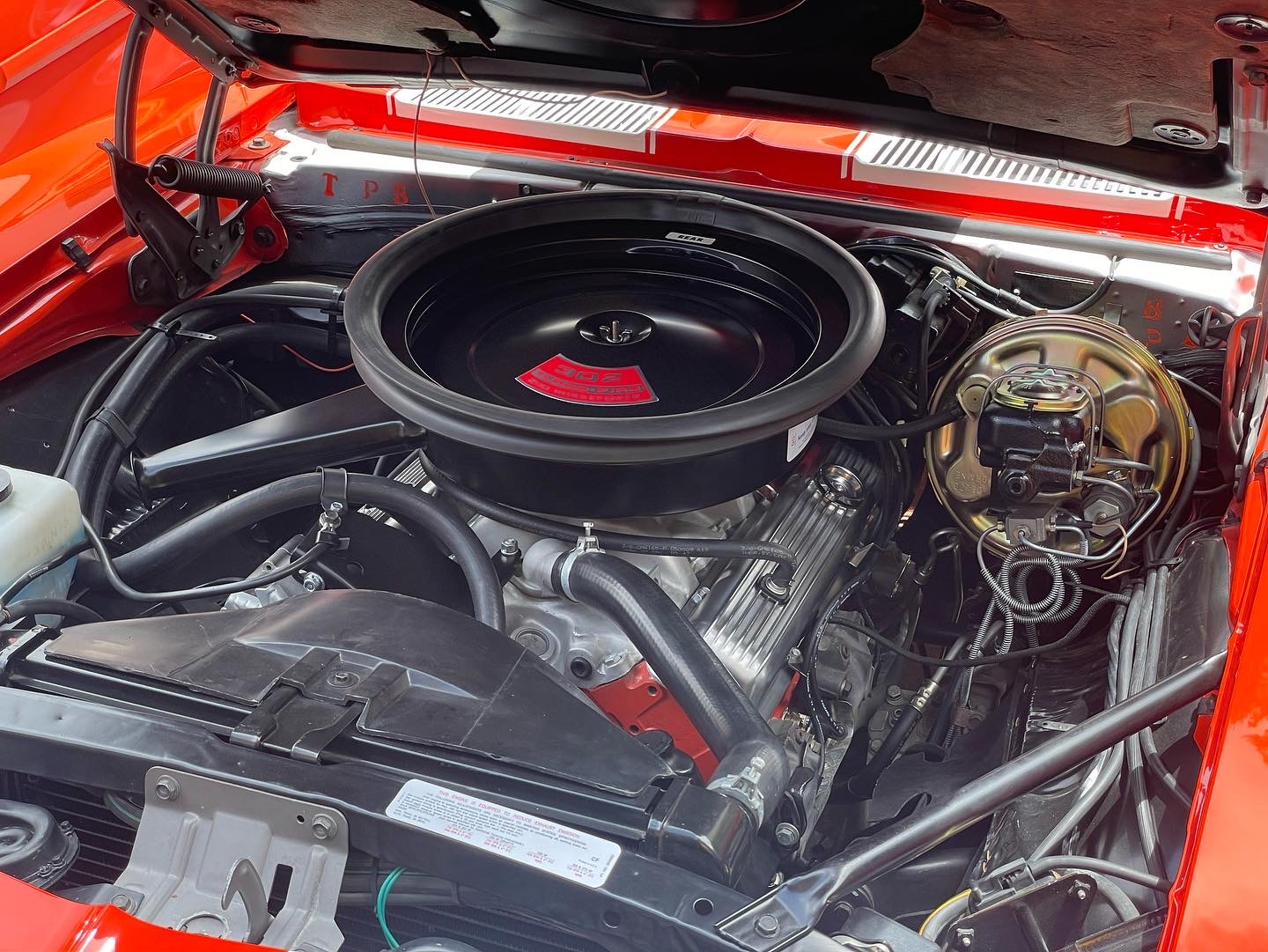

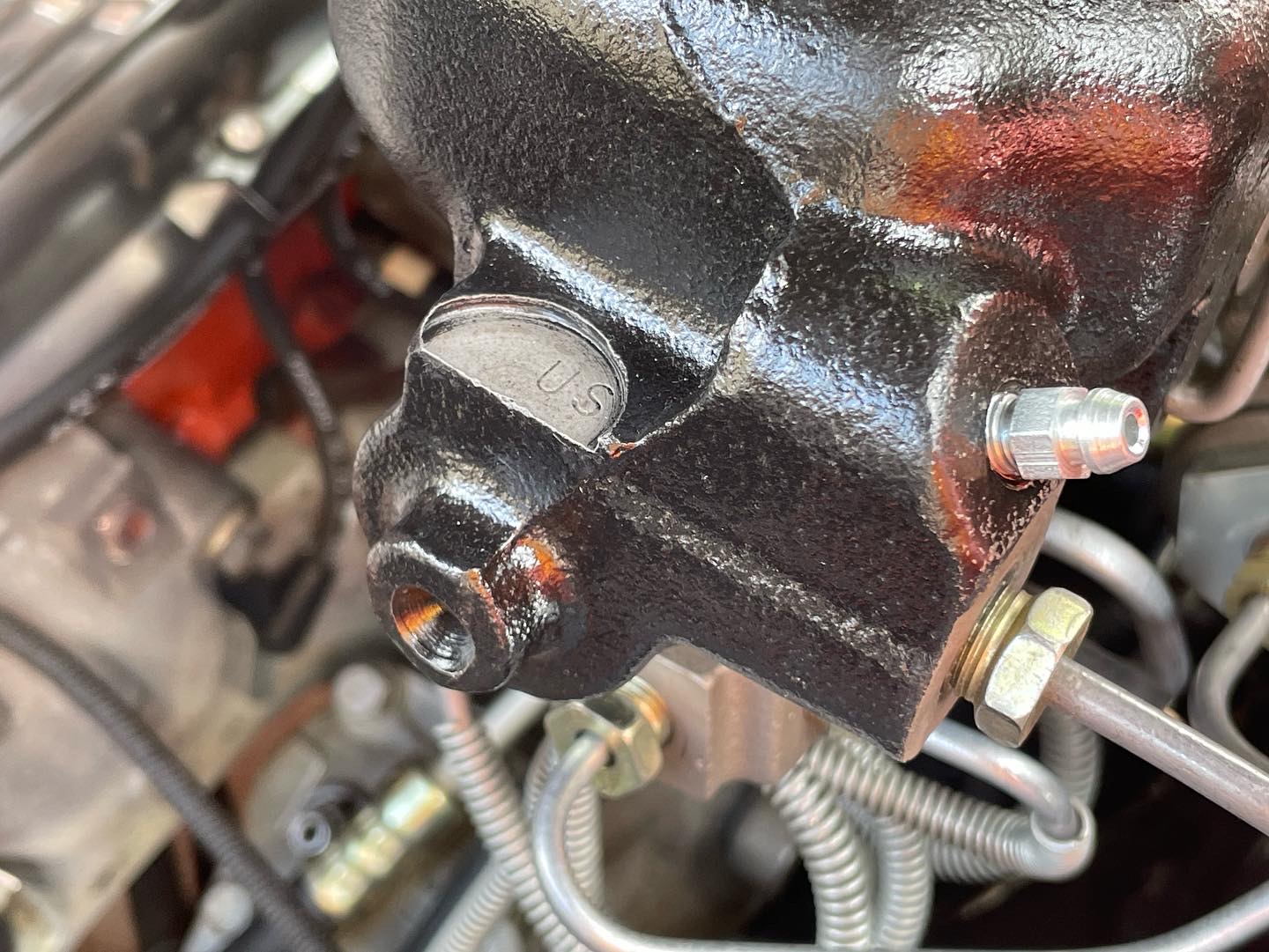

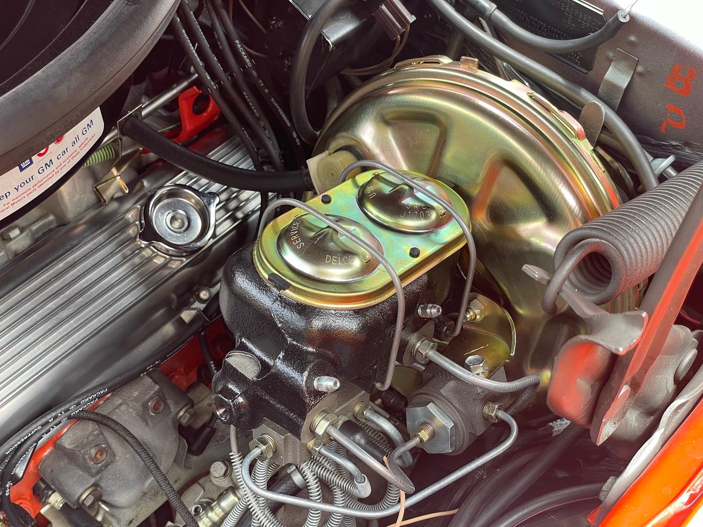

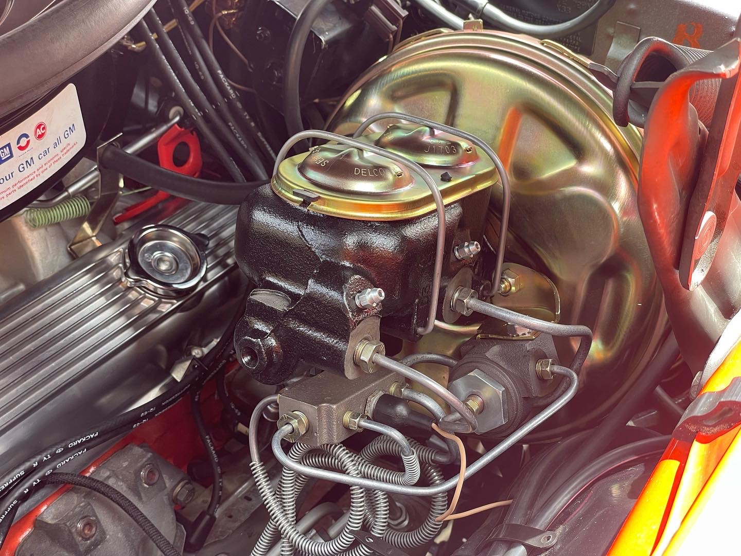

It has been too long since I posted so time for an update! Since October it’s been a combo of enjoying the car around town, meeting great folks at cars & coffees, and working on a whole lot of projects, mostly in the engine bay. I’ll post the latest project first - I had the original 9204 booster and 309 master cylinder in a box from when I bought the car, and so I finally sent it out to Mike Gibbons and Brake Boosters. I also had them restore my original metering valve and replate its bracket, plus I sourced some restored hardware from Rich Pasqualone. This is no surprise to folks who have worked with Mike but everything came out beautifully!
Installed everything and got the brakes bled this weekend, now taking a moment to enjoy the view. I’ve still got a few little projects left to go but this engine bay has come a long way in the last year and a half

----It's so nice to see a correctly done master cylinder. Yours may be a tad too nice, but I love it and the fact that you left the machined areas bare. So often guys just paint the whole master black and that just didn't happen!.....Bill S
