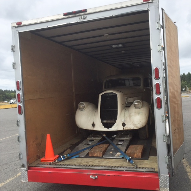

E trac is the way to go ...
All my enclosed car haulers trailer have heavy duty 50K rated etrac that is bolted thru
both floor layers - you can drive over the heavy etrac without deforming it.
