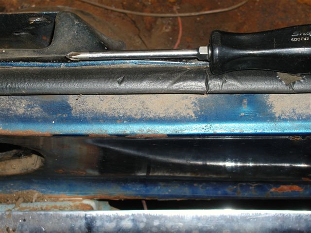

In the plant, the Fisher Body spec was to place the cut-and-trimmed joint centered on the latch; we used a small bead of pumpable black sealer/adhesive applied from a flow gun all the way around the gutter before rolling the seal into place, and used the same sealer to glue the cut ends together at the joint. Photo attached of my original 02D Norwood '69 joint.

My 08A Z/28 had the joint about a foot left of center.
Also had black adheasive.
Thanks for the pic John.
