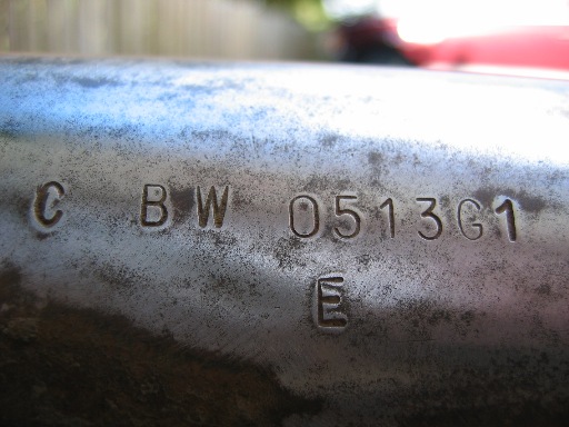

The June Novas that I've seen have rears built at the Detroit plant, it could have been the 'changeover' month though as we've seen other '71'ish items begin changing over in June of '70, (seat belt retractors for example).
Here's one dated May, but the June rears are the same syntax.
Marlin
Old 03-12-2008, 09:50 PM
Posts: 21,008
Thanked 3,706 Times in 1,491 Posts
Default Re: 12 Bolt Casting # Help
What's the casting date on that one Marlin?
