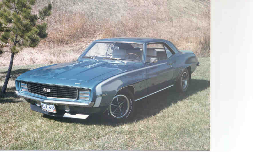

your pics don't work. Here is an example of the early style hockey stripes that extend onto the lower fender extension... "Killer" reference material.
