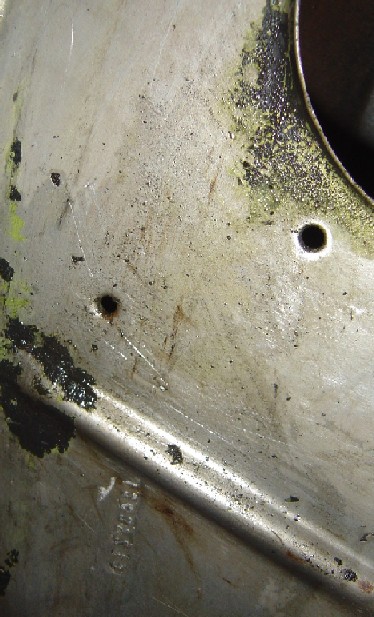

I'm looking for a little help with the authenticity of a 1970 396/350HP Chevelle SS.
The car in question was made in GA, it has a 396/350 TH 400, etc. The vin tag matches the build sheet with the body code 13637 as well as the last 6 digits of the vin and the title matches the vin code. The number on the body tag matches the block on the build sheet that says seq number. Behind the right rear tire on the top side of the frame there is a number stamped that contains the last 6 numbers of the vin. I believe the numbers on the frame before the last 6 digits contain 0 and A and possibly 1, but it is difficult to see with the body jacked up only slightly off of the frame at this time. It appears to be stamped twice with the same number in two different directions on the frame.
The build sheet has a code that says "ZL3 SS 396 Conversion", is this normal for an SS 396 to say "conversion."
Here is where the question comes in, under the heater box on the firewall there is number stamped on the inside of the firewall that is inside the heater duct area. The number stamped in this area reads 13437Z19. I would expect it to begin with 13637 since it is V8 coupe as opposed to 13437.
The car was orignally painted a special paint code "927-99846 Green A.L." as noted on the build sheet. Build sheet also has "ZP3 Spcl Paint." I believe that this is citrus green. The car was formerly this green, inside the door jambs, everywhere it has traces of this green now covered in 73 corvette blue.
Another questionable area is the vin tag, it is riveted to the body in the normal location with star shaped rivets but the rivets appear to be in upside down. The star side is on the bottom and not on the top or visible side as is typical with modern cars. I never noticed this with the dash pad in place, I have noticed it now.
I spoke to the previous two owners and they say that the body has not been changed nor has the vin tag been removed and reinstalled. I've owned it for 20 years (1985), the previous owner bought it in 1977 and the owner before that bought it a while before 1977 from his brother in law and sold it when his work commute increased. All former owners that I spoke with said that the car was not wrecked, the body was not removed and replaced nor was there any significant damage to the car or frame.
I realize that this is not an LS6, L-78, or super rare car but it was my post-high-school car when I graduated in 1970.
Is there any chance that when the car was ordered in this color that GM grabbed a painted body shell and changed the vin and put it on top of a frame that was set up for the SS with F41 components, big fuel line, bigger sway bars? If this is the case they would have had to change the vin, and if they did change the vin in the plant would the car have had the windshield in place already causing them to put rivets in upside down? Are there other cases of rivets in upside down? Are there cases of the body code being stamped incorrectly in the firewall?
Did I get taken for a ride some 20 years ago? The car was fun when I drove it, it is stored now.
I enjoy the posts and the level of detail from the experts, I just signed up recently. Any help is appreciated.

I think the stamp you are referring to on the firewall is the part stamp. It would be the same as the base coupe so the part number is the same. The hidden VIN would have the plant code and vin sequence.

Thanks for the reply, can you tell me where to look for the hidden vin that you refer to?
Is the car guaranteed to have a hiddeen vin as you refer to?
Can you tell me what the "Z19" means?
Thanks again!

Pull down the rear license plate and look at the recessed area directly above the fuel filler neck. See if there is a number stamped there. If so, what is it?

I have tried to locate a number in the recessed area above the fuel filler but have not found a number yet, maybe a little more scraping to remove the sound deadener etc.
I decided to strip the firewall with a spray can of stripper. The stripper quickly removed all of the black paint to reveal over the tunnel two distinct markings where the metal is more shiny than the surrounding area. It looks like a kid wrote on the firewall directly above the tunnel with a crayon "13637" and "ZL3". Also at the top recess of the tunnel there is also a what appears to have been written "021" I got some photos of this to show the contrast of the metal and the location.
The build sheet does call for the ZL3 conversion.
I could find no stampings on the outside of the firewall except some numbers on the brace that the fender bolts to near the top and it was marked something like 23. The lower brace that includes the front body mount has some numbers stamped on it as well but only a couple digits, maybe 4 or so. I assume these were part numbers for the individual components prior to welding together.
As I mentioned I cannot find a number on the rear but then again the storage facility has no lights. A flashlight and a piece of sandpaper were not producing results in the dark.

Don't be alarmed if there are no numbers in the rear. I have researched this a little bit and it seems the 13637 Malibu's had no numbers but some of the 13437 Chevelles did. Just wanted to check to see if yours had a number there.

ZL-3 Conversion is common among these cars.It merely lets the assembly know to prepare the body for a Super Sport provisional upgrade.
Paint production code 927-99846 is indeed Code #43 Citrus Green Acrylic Lacquer.Does this Chevelle have white Band aid stripes & a Flapper door Cowl Induction hood?
