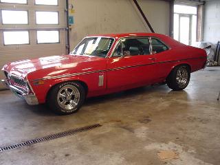

Im from Holland and own a '69 nova 396 ss with muncie 22 and
12 bolt with 4.10's. Powersteer & brakes original + 4 disc
brakes.
( car = full matching, exept engine =
crate 454 new).
I want to rebuild the car to a yenko 427 nova ( with the 454)and because the base is already very close, im im need
of some help with correct paint codes for my painter
In eather: Ralley green / Hugger orange / or the nice
bleu color. also need and stripe / decall kits.CAN ANYBODY GIVE ME A HAND ?
Over here in europa its hard to find parts / date on this
subject. I wanna buy al thats needed in the us and need
as good as it gets parts for the transformation.
( original stuff also welcome !)
Thanks for any help !
P.s this is the car.

That's a very nice looking nova. Looks like it has the factory belt line trim. There are trim studs under that trim that you will need to grind off before you apply the stripes.
