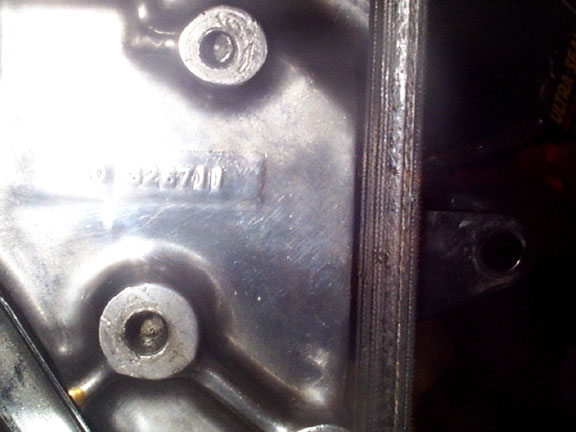

How about 0-326711

Do you mean this one Knappy? (Sorry about the flash glare)

I have an aluminium block with thoses numbers. What are those numbers in the picture on?
