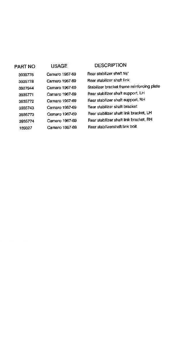

Old 01-30-2004, 01:28 AM
Mark_C Mark_C is offline
Join Date: Sep 2002
Location: Shrewsbury, MA
Posts: 461
Default Re: '67 Camaro Rear Sway Bars?
Heres the parts list for the rear sway bar.
Mark C.
