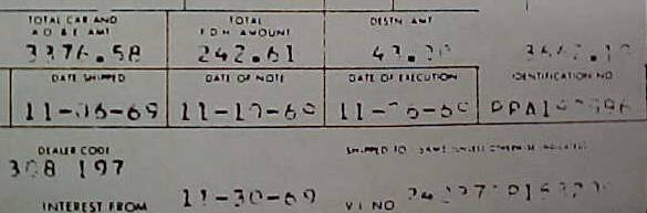

I wouldn't call it case closed until someone can show proof that the car arrived at Knafel before the engine was actually built. Does the PHS documentation show when the car was shipped to the dealer or when the car arrived at the dealer? Or can someone produce an NICB report showing the date Knafel got the car? That seems to be the next logical step in proving or disproving.

Default Re: 70 Judge RAIV and V continuation
Jeff
This is all I have, and it probably has nothing to do with time spent in engineering.
Jim M would probably be the next hope for documentation. Supposedly all of Knafel's records are destroyed.
Take a look at the attachment in the reply that Steve posted about this question. The document clearly shows a ìDATE SHIPPEDî of ì11-06-69î It also shows a ìDATE OF NOTEî of ì11-19(?)-69 and a date of ì11-30-69î as ìINTEREST FROMî.
Think about it Steve. You work at a car dealership. Do you really think that the owner of a dealership is going to pay INTEREST for several months on a car that they have not even taken delivery of? [img]/ubbthreads/images/graemlins/rolleyes.gif[/img] [img]/ubbthreads/images/graemlins/no.gif[/img]

My families dealership never had a car go to engineering that I'm aware of, so I wouldn't have anything to look back on in our files to verify that either way.
Date shipped, could be the date it went to engineering, and interest from could be when it left engineering.
Rita your doing a great job, we just need some way to verify.
We have a man that will probably be making a post some time today that will probably establish your theroy on the date code correlation with the production number. He also thinks all of them started in a 6. If your theroy is correct, all we have to do is find the date it left engineering. It will either prove it didn't happen, or leave the door open.
I'm working on the your date code theory, you think you can find out if the dates on the invioce actually reflect engineering?
