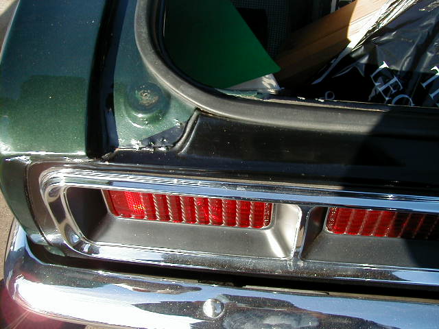

The one I have looked at I specifically looked under the trunk lid near the Trunk weatherstripping in areas where you would not polish and they were Gloss. At Scottsdale 2 years ago there was a pretty neat British Racing Green SS 396 that still had the Gloss. Somewhere on my computer I have pics.
Just looked at a original paint 18K Cortez 69 SS.....Gloss black in the trunk jam and rear panel. The jam is rough and not well cared for (not waxed) but it is a gloss finish.

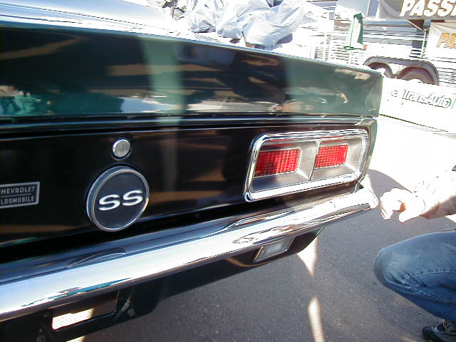

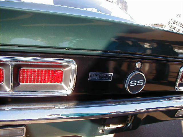

Here are pics of the low mile car that was at Scottsdale.
Another
and again
Charley, thanks for posting those pics of that 68. That tailpanel is not 100% gloss like the rest of the finish on the car. You can compare the reflections that are in the spoiler to the same ones on the tailpanel and tell that the finish does not have the same gloss. That is exactly the way mine was behind the bumper when I removed it. The term "gloss" is used too loosely in the restoration industry. There are varying degrees which determine the final sheen/shine. That is why there are more incorrectly painted tailpanels, firewalls, air cleaners, heater box covers, rocker panels, and dash boards. If the proper flattening agents and spray techniques were used then you would see more correctly restored cars done. However not everyone today can use the spray gun at home or even has access to the correct paints used so they are left to whatever is close in a rattle can.
