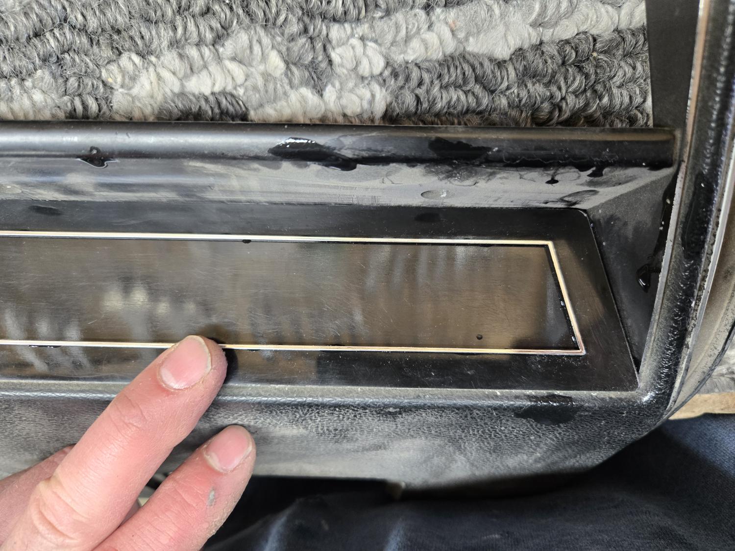

Radio Delete plate is pretty nice, but it was way oversized on all dimensions not allowing it to sit in the dash as I think it should. The plate sticks over the lower chrome strip edge that is exposed. It was also too wide. (first two pictures) All sides had to be trimmed. The one i bought had an original label from the Parts Place.
Last few pictures show how it now sits down inside the recess. Had to make a bracket for function, rather than perfect originallity. Once complete it fit very nice

Here's an NOS '69 for comparison. Fine work you're doing.
