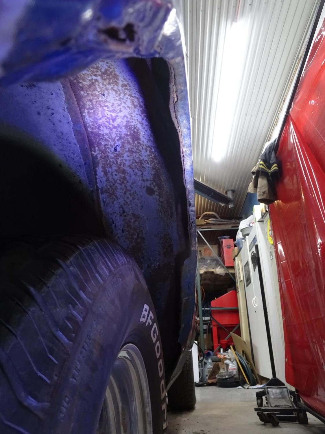

I bought this car in 2016 and have been collecting parts for it and waiting to get started on a restoration. A move 3 years after purchase and a "mild" restoration of my Camaro that turned into a full blown, rotisserie resto kept putting it back.
Early pics of what it looked like when I bought it. It came with some crappy fitting repro fenders that I swapped out for an original pair from another '70 I had. No engine, trans or interior. My typical stripped, gutted basket case vehicle. It had a full set of factory SS wheels but the seller wanted too much for them and I have a set from the '70 I bought in '73, so the wheels were mine.

The floor and trunk are complete toast, but with the front clip off, I looked over the usual areas of the upper and lower cowls and it is surprisingly good.
