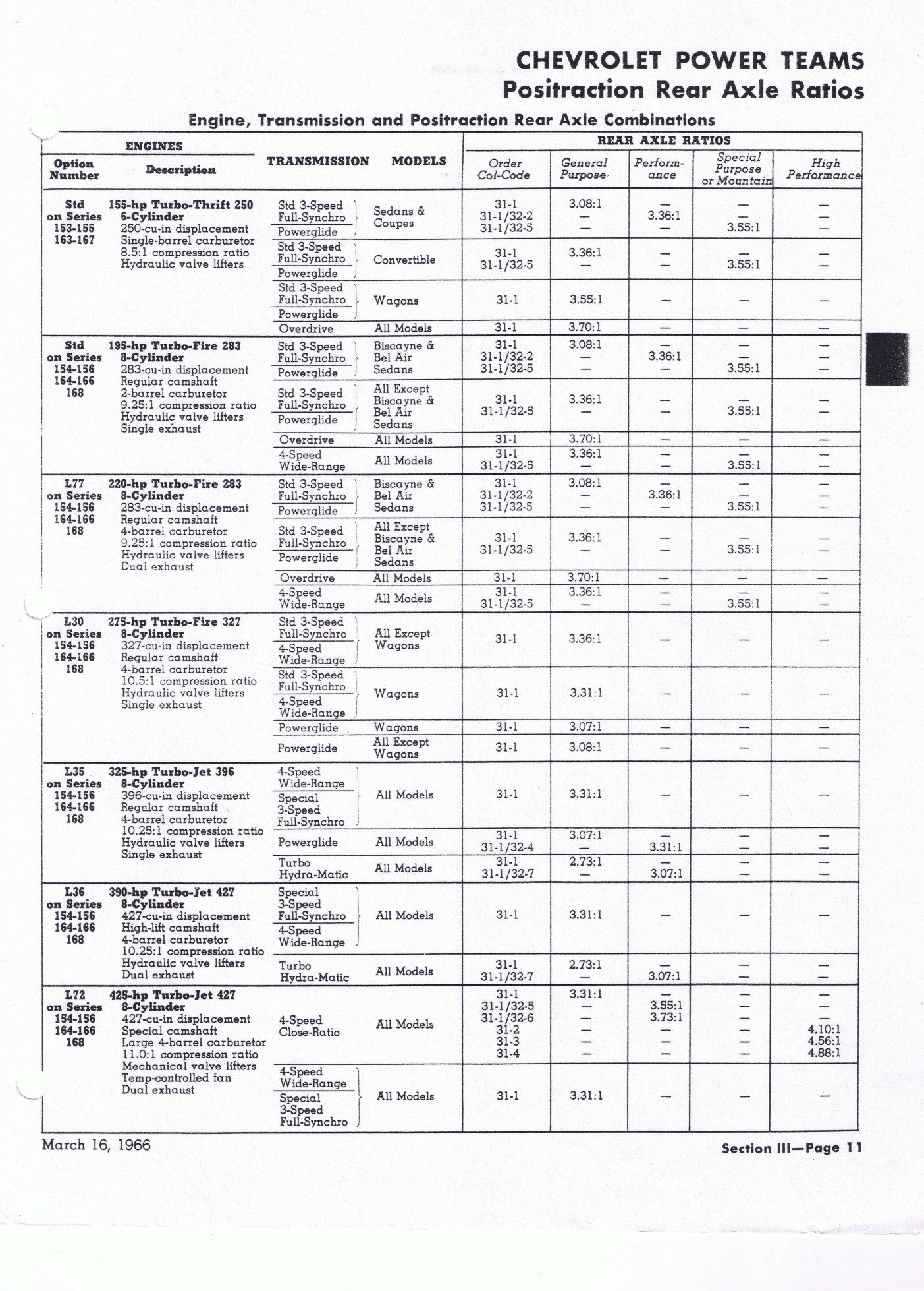

Price and facts book 3rd edition, Re; Tach and Trans info
Power Team Chart:
[email protected]

so, if my car has a date proper 4:88 12 bolt and an M21, with the 2Q on the tag and the proper v8 vin, what's the chances it isn't an original 427 L72 car?

Default L72
This is all I can say based on the following. If the trim tag is original, we know that a Group 2 code Q means the car came with an M21. We also know based on the previous posts that the only engine for the 66 Full Size Car including an M21 was the L72. If in fact the Trans is original to the car that further substantiates the L72 once again. I would be curious if the Tach harness was up under the dash as the car would have had to have a tach.
Records show a combination of model 15411 and 15611 total of 225 L72's between the 2 DR Biscayne and 2 Dr Belair.
Paul
[email protected]
