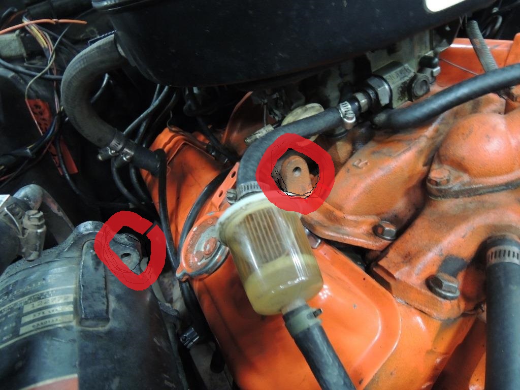

Default Missing bracket
Also missing one bracket. Goes from the threaded hole on the compressor (circled) to the threaded hole in the bracket on the intake (also circled).
I am sure it is similar to the one on the 67 above. But, mine is a small block.
Anyone have that bracket for a small block 68 vintage.
