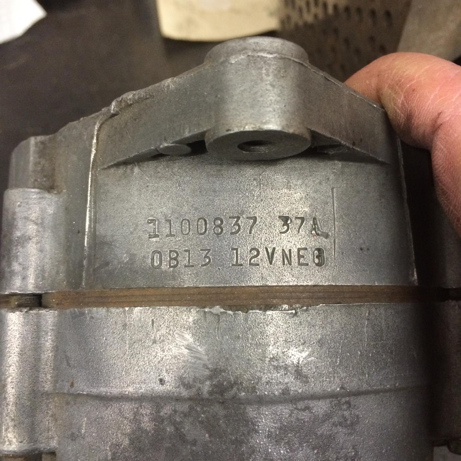

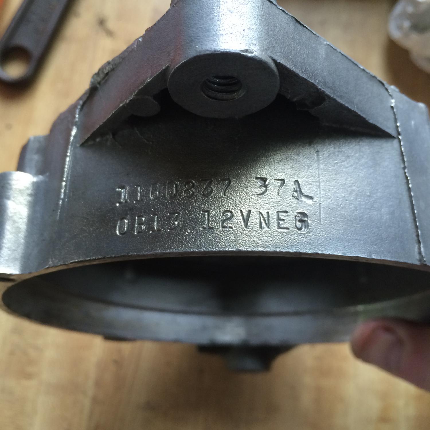

'837 alternator case before-after nitric acid "desmutting" soak. Not too bright, just clean and aluminum oxide tarnish removed
