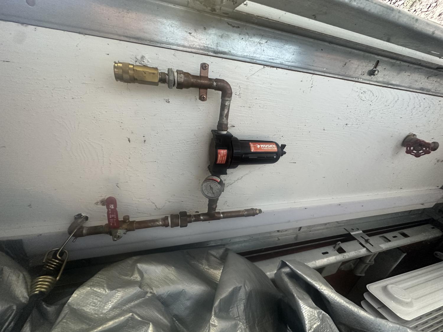

I went with copper lines.

Black iron or type L copper pipe.
