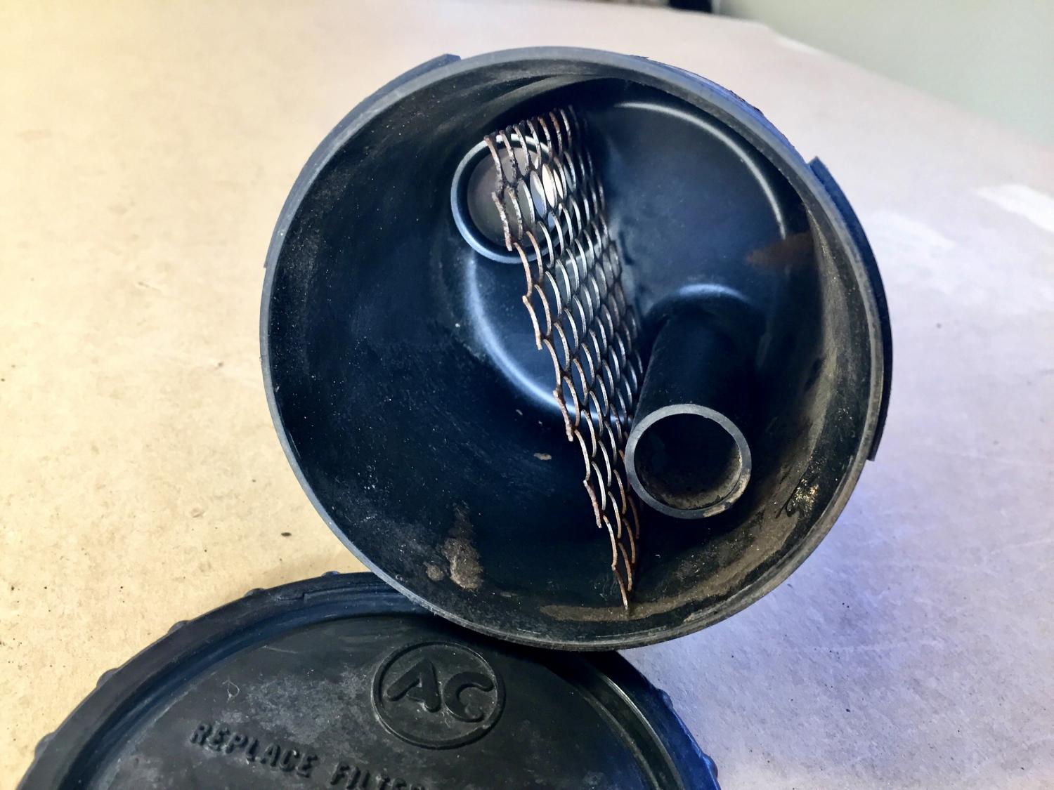

Aside from all the plumbing, molded hoses, special air cleaners and the separate air cleaner for the smog pump this unit also required a different center carburetor that has a ported vacuum. A small steel line comes off the RH side of the center carb “above” the throttle plate.

----Chris,,,That smog pump air-cleaner is close to or the same as was used on 67 442's. The California sold 442 I once owned had that muffler plus about half of the rest of the smog set-up in the trunk when I bought it....Bill S

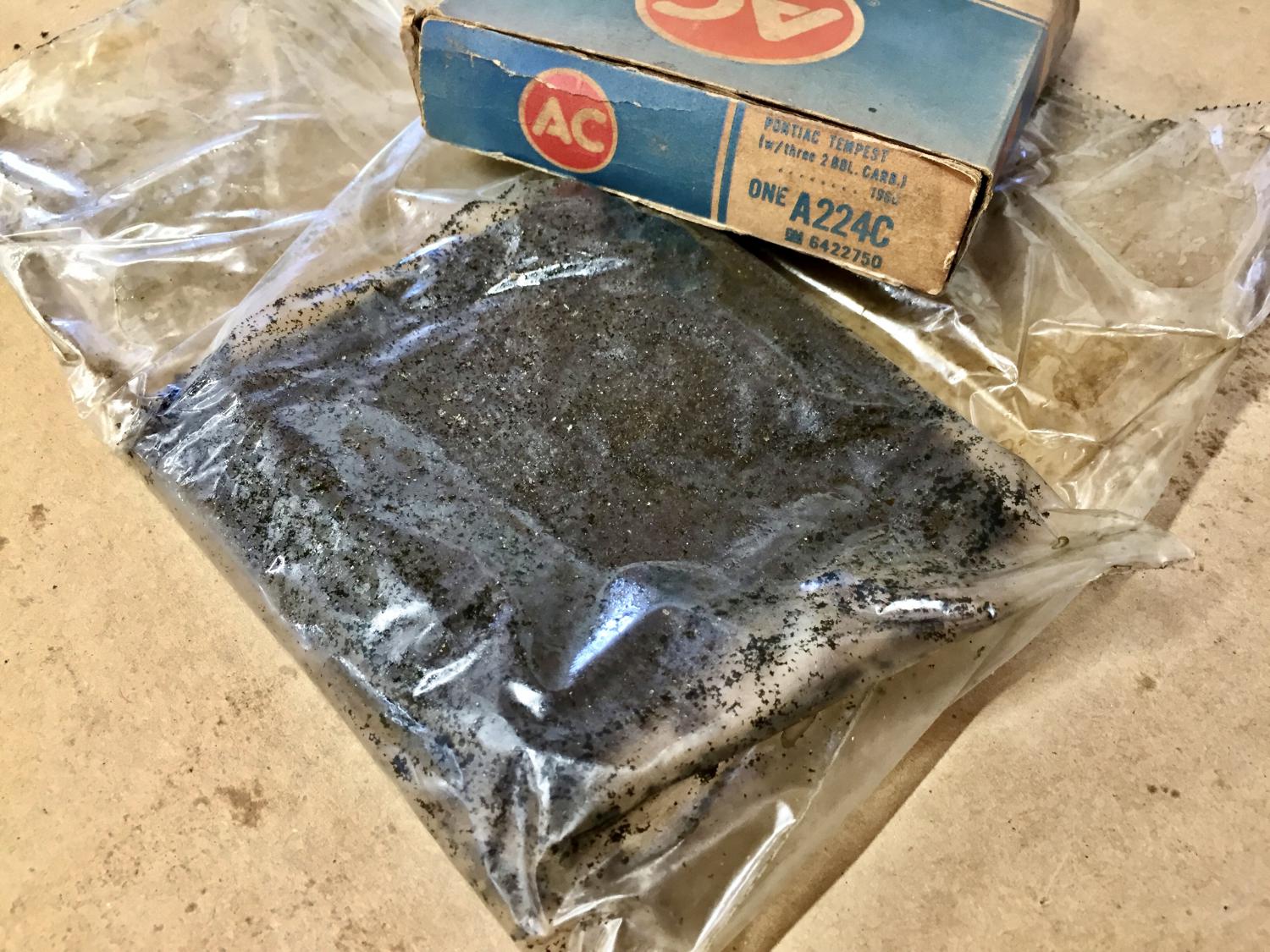

These 64-66 Black & White photos are from old test car articles showing the Tri-power GTO’s engine bay.
All having their OEM foam air filters.
