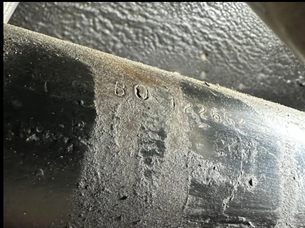

Back in 2012 it was being asked about on camaros.net. Was bought as an original drivetrain car
https://www.camaros.net/threads/cowl...estion.208521/
Has a 388 block with casting date of K-16-8 and a rear is a BO1226G2
124379N609445

VIN on block almost looks like something under it. There is a bare pad picture on the camaros.net thread and I don't like the stamp there either.

That rear axle stamping looks altered also. The O in the BO stamping looks to be stamped over.
