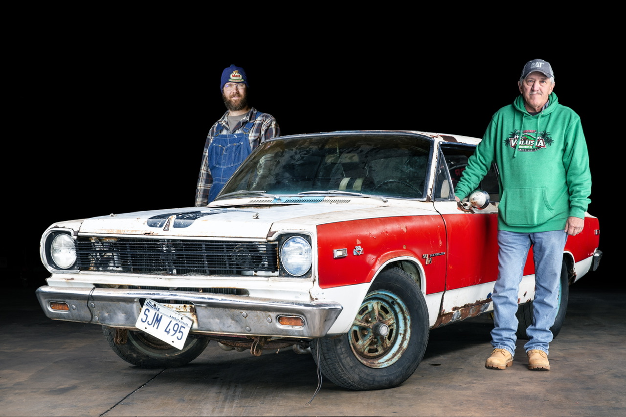

Then it got accepted into the Barn Find area at MCACN 2023, so a new plan was hatched. The block was as the machine shop and I was already building a 13:1 390 using BBC rods, Pontiac 455 pistons, the largest Mechanical flat tappet cam that Lunati makes, and ported 291C heads. Why not have this thing running and driving like a vintage pro-stocker while it looks like it currently does?

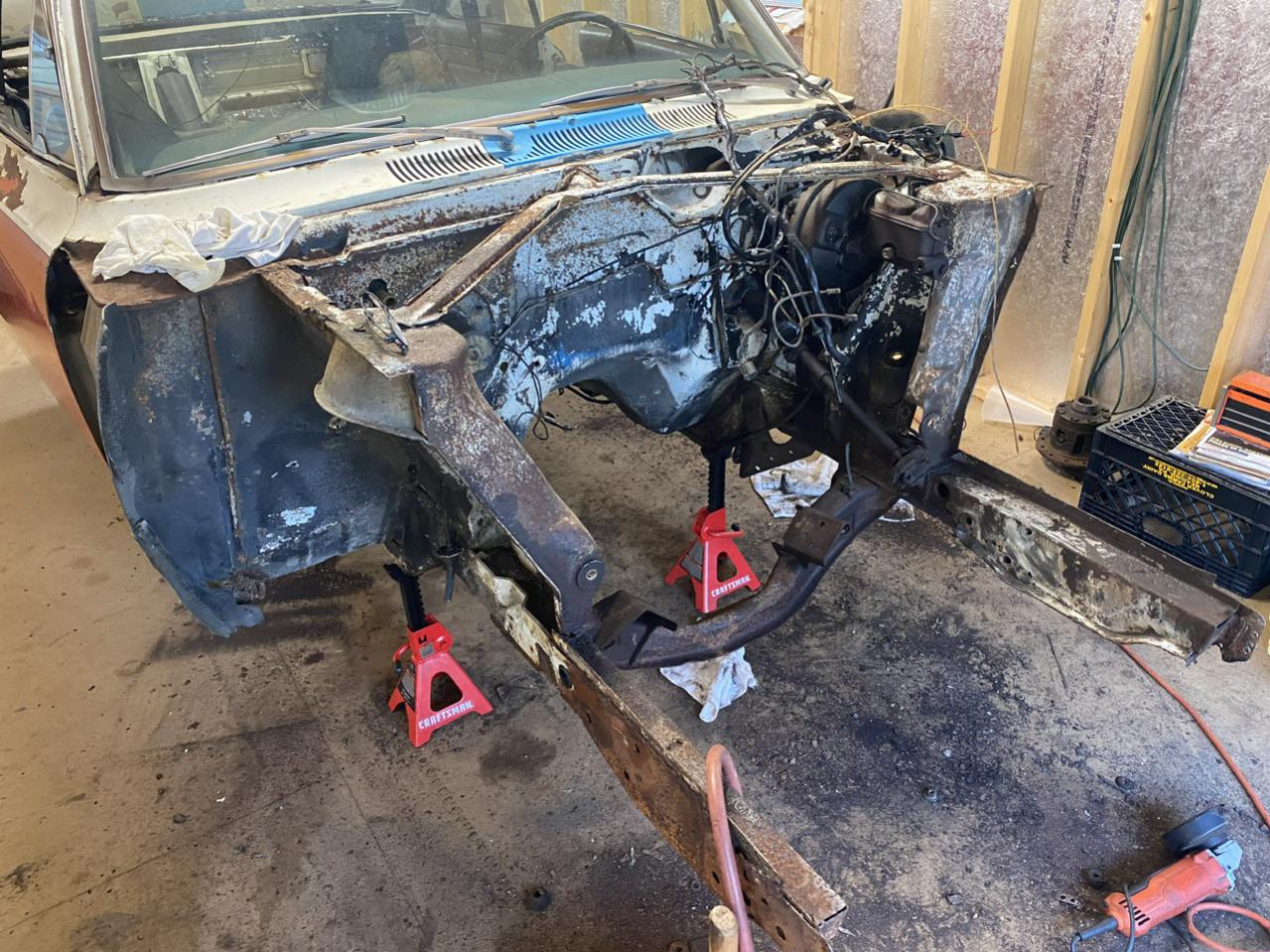

Unfortunately I had started stripping the interior of the car to start the bodywork. So over the course of months I reassembled most of what matters, and tackled the largest metal job that needed to be done… that right frame rail.
It was junk. So my dad and I, without fear or any idea of how to do it, chopped the right front frame rail out of the perfectly good 290 parts car and began mocking it up in the SC. There were some changes from 1968-1969, but nothing that couldn’t be overcome. Soon enough there’s a complete frame in the front.
Now back to the engine. Assembled in my garage and after all clearances are checked, it was installed not painted and ugly, along with the original T10, though there’s no vin on it the dates line up perfectly to the build date of the car.

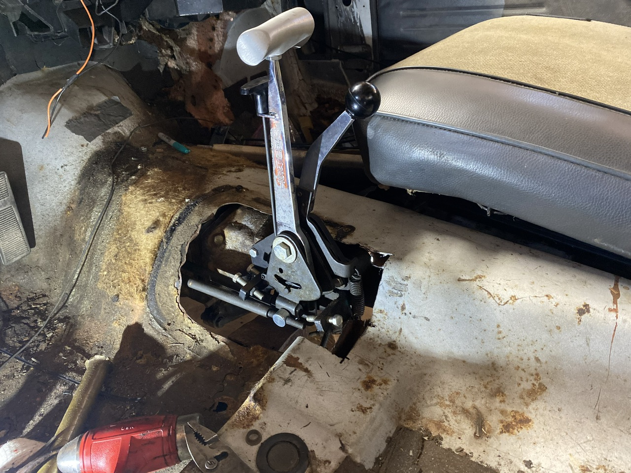

So at this point I’ve condensed about a year’s worth of work into the last post. The engine is back in the car with the trans, the frame seems like it will support it without falling apart, and I’ve put the interior back together enough that I can mount 1 seat bolt into each seat since there isn’t enough floor left to install any other hardware.

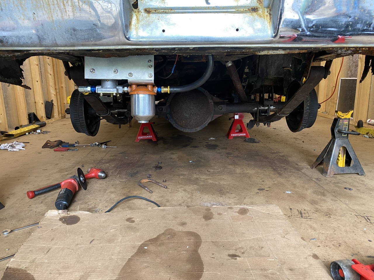

Looking at the rear one day I realize that not only is it crooked, but both spring perches look like they were eaten by a T. rex. I had purchased a NOS set of 4.44 gears for an AMC 20 months earlier. Figuring now was as good a time as any, I pulled the rear out of the car and replaced the spring perches and rebuilt the rear with new bearings and the deeper gears.
While installing the perches I found that part of my issue with the rear being crooked was that 1 perch was welded onto the rear backwards. But even after fixing that the rear is still slightly off in the back of the car. Measuring underneath shows that the mini tub job is about half an inch off. Pushing the right side tire closer to the front of the wheel opening. The next post will talk about the cars history and how I found it going back to about 1973. I’d love to trace it back further but hit a dead end. Enjoy the photos.

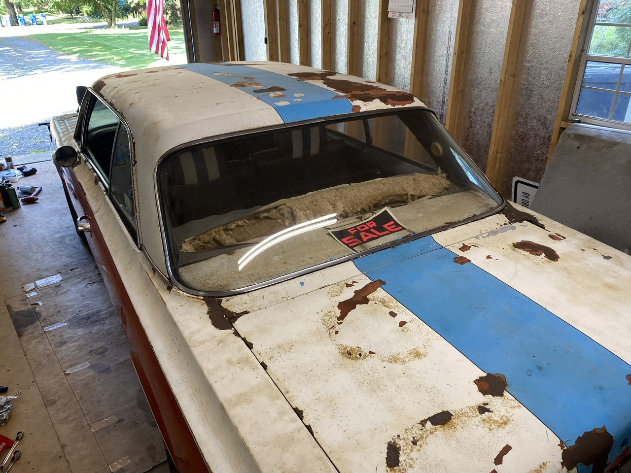

My trail went cold there, then, months later I decided to take the rear window regulators out to free them up. Inside the drivers side quarter window slot I found a For Sale sign with a phone number. Googling the number I eventually tracked down a disconnected phone number to Astoria Queens. Bingo.

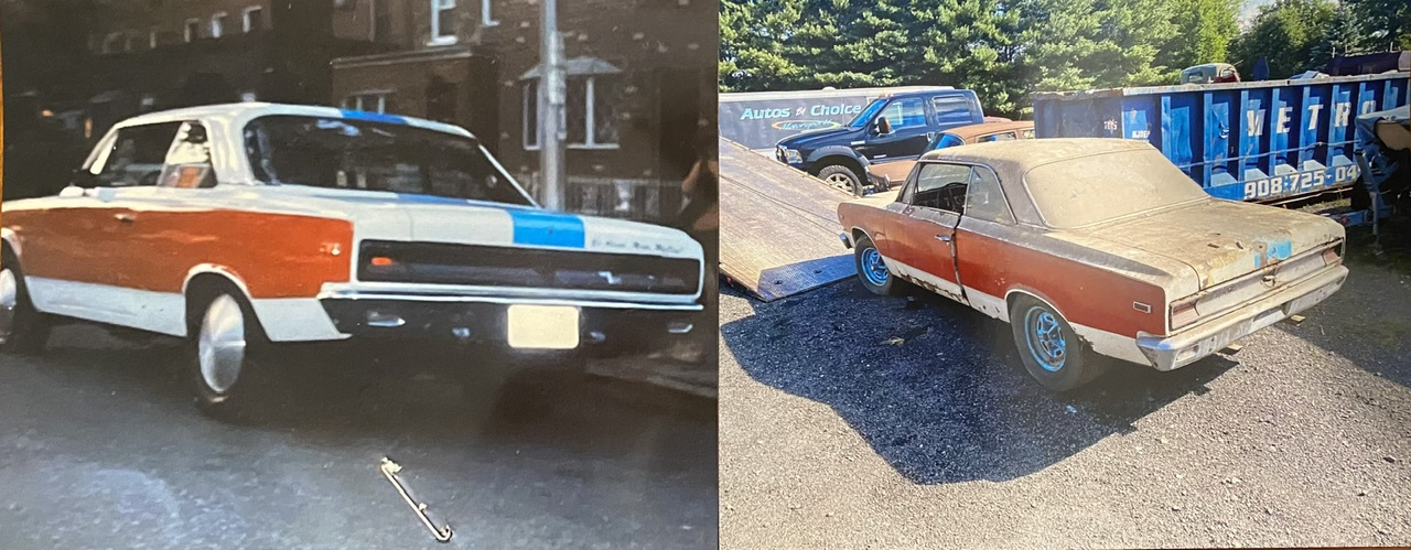

Brian was kind enough to send me photos of when he owned the car. The photos are from him getting ready to go to a car show at the now torn down NYC coliseum.

Photos from MCACN 2023 and a preview of a Hemmings photoshoot that was done a month or so later. The photographer is still working on the article. Very nice gentleman named John.
