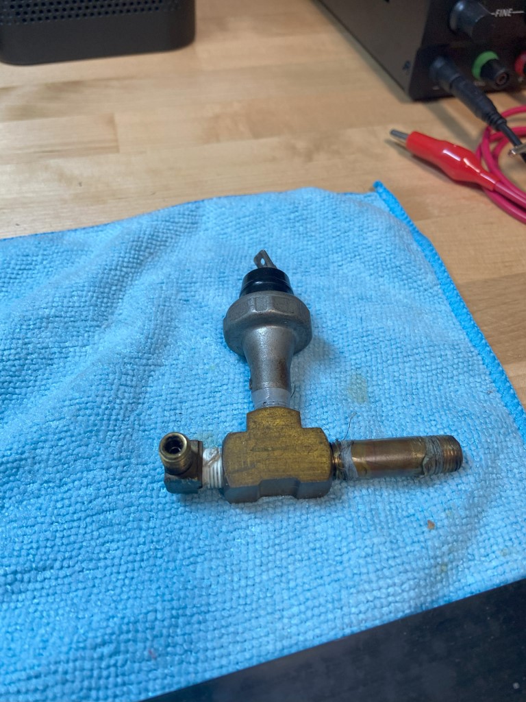

Trying to install a period correct mechanical S-W temperature gauge and still run the factory temp lights in the dash in a 62 409-409. As far as I can tell the temp sender location at the front of the factory 881 2x4 manifold is the only location to install a temperature sensor. Any suggestions to be able to do this or do I have to give up the dash lights in order to run the gauge?

I have done this, but it's not pretty. I used brass fittings to look a little better.
Use a nipple into the intake with a T standing on end for the mechanical probe to go straight down. The electric sender will screw into the side of the T, but if it is too long, you will need another nipple and a union for the sender to screw into.
This was on my Pete to run 2 different temp senders to activate the fan for summer/winter, but same principal. I had to switch the harness plug from the 160 to 195, but they both "read" the water temp all the time.

This amazing example of day 2 engineering was installed by the original owner of my 69 Z for two oil pressure guages...
