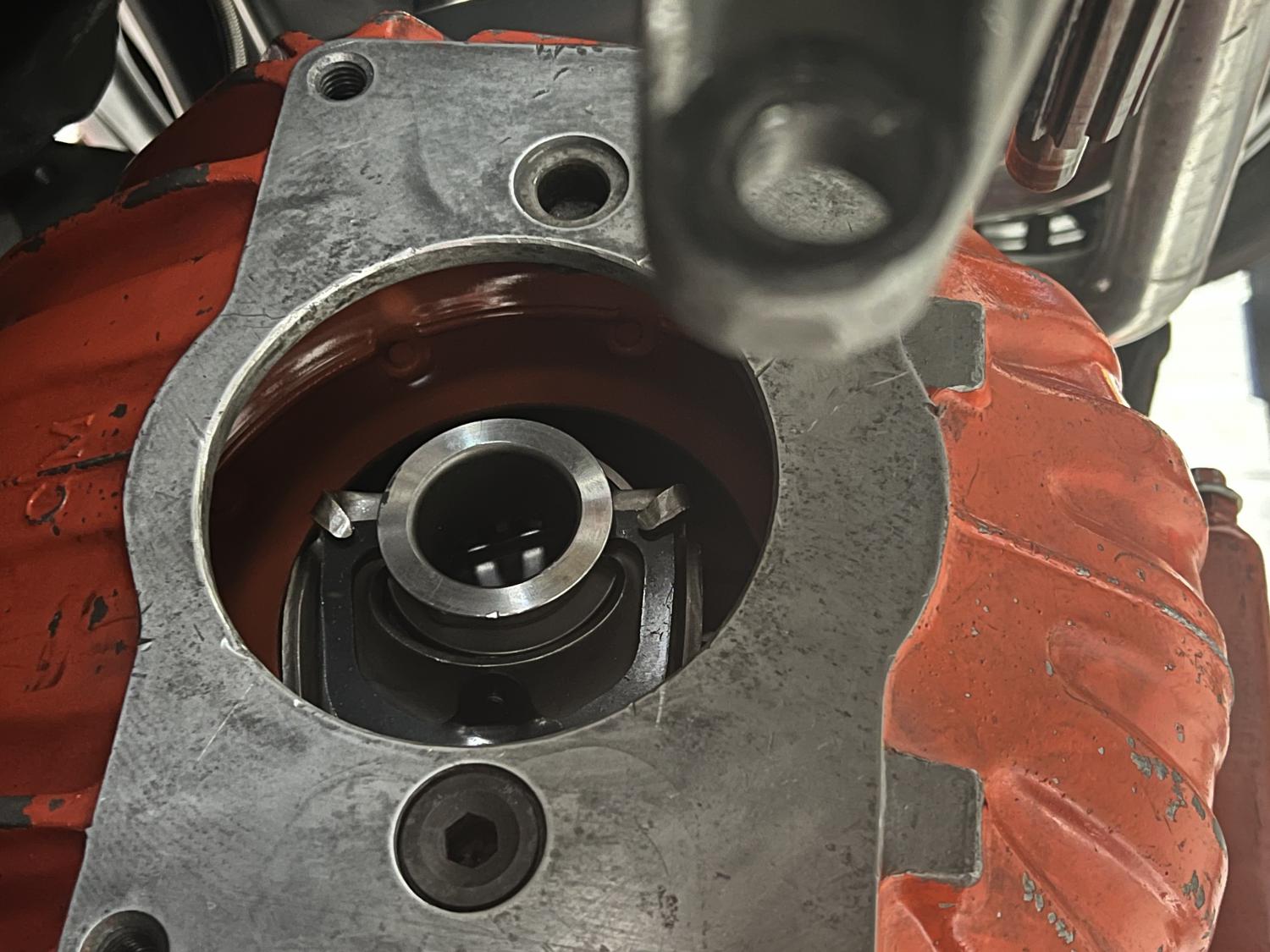

Your throwout bearing is sitting on the fork wrong.

That it is. Nothing like a piece of humble pie in the morning. Better to know that now that after the car is running. Thanks for pointing it out.

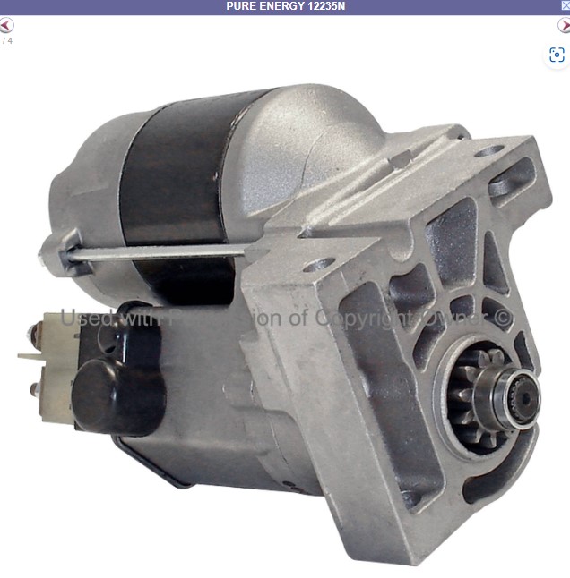

And that starter bolt... can't believe that doesn't let the starter move and slip on the flywheel teeth.
