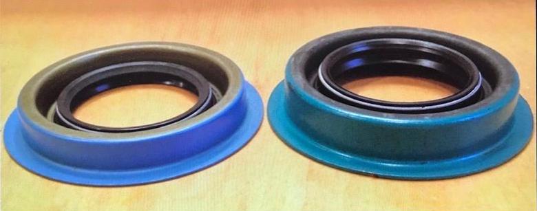

The truck seal does work in the car housing. It puts the rubber lip in a different location deeper in the housing. As long as it's not too deep it will work with no problems. Some of them are made too deep and will cause problems. You just have to be sure that you check it when you install it and be sure that the rubber is not making contact with the bearing.

Agreed, Fred. I post this photo solely for future reference.
