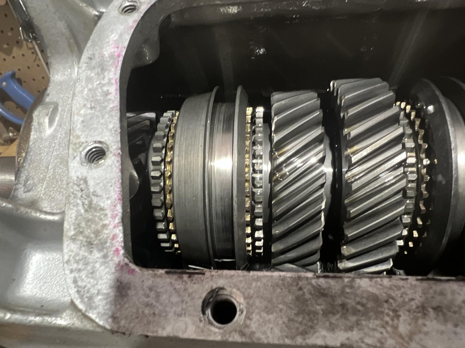

Send it back to the builder.... Not a external problem, internal that should have been addressed on the rebuild..
I agree, definitely an internal issue with the 3rd gear synchronizer assembly or the small teeth on the 3rd gear. Bill

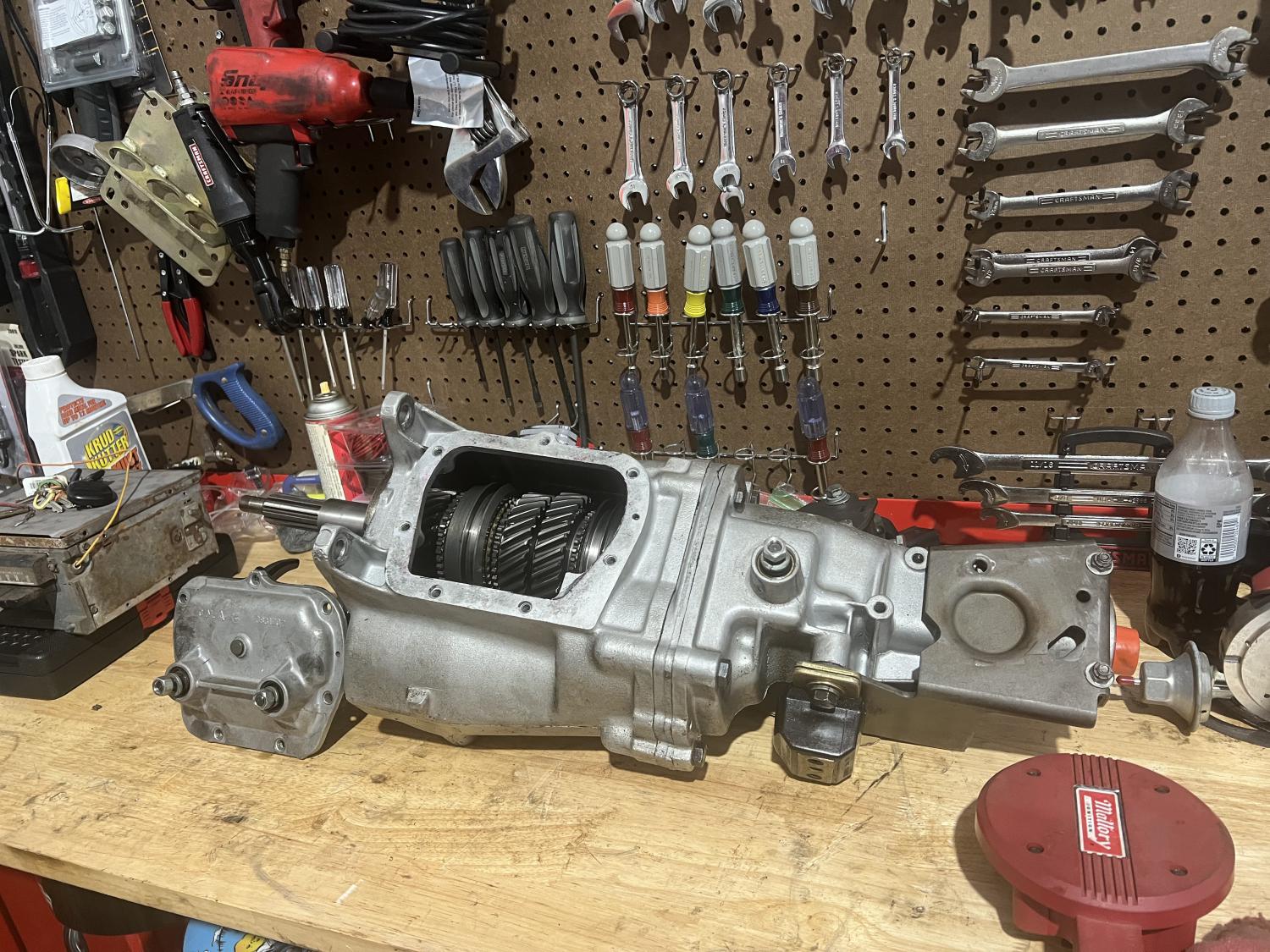

I spoke to Paul Cangialosi yesterday and sent some pictures of the trans to him and he said the issue was the prior builder of the transmission used a locking third gear with a non locking slider. He also recommended hardened hubs, new sliders, and new shift forks. I’ll post some pictures when I revise receive the parts and start the tear down process.
