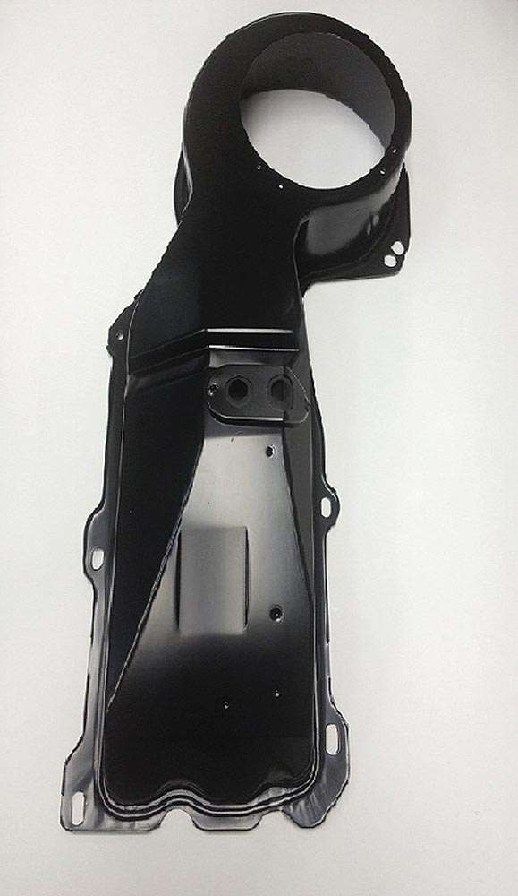

Ecklers sells the following heater box cover that is show correct. I always thought the only difference in the small block and big block cover was the center punched holes. This box and a square indentation that the small block doesn't. Is this correct?

No.

Thank you.

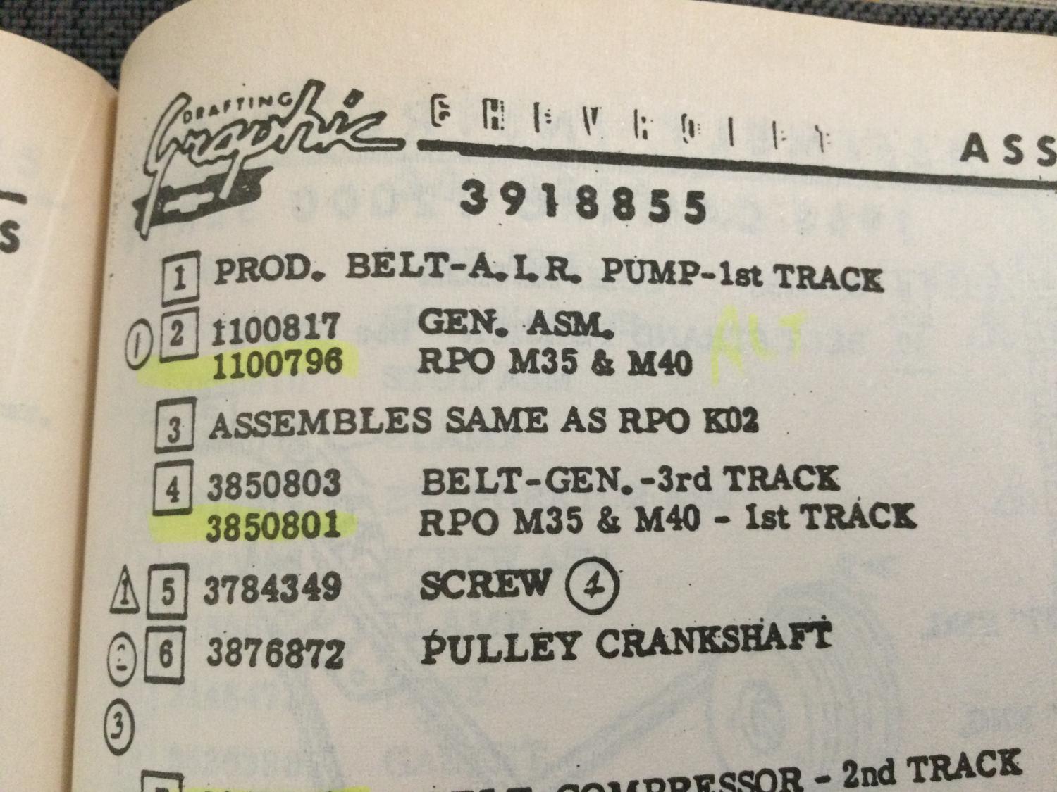

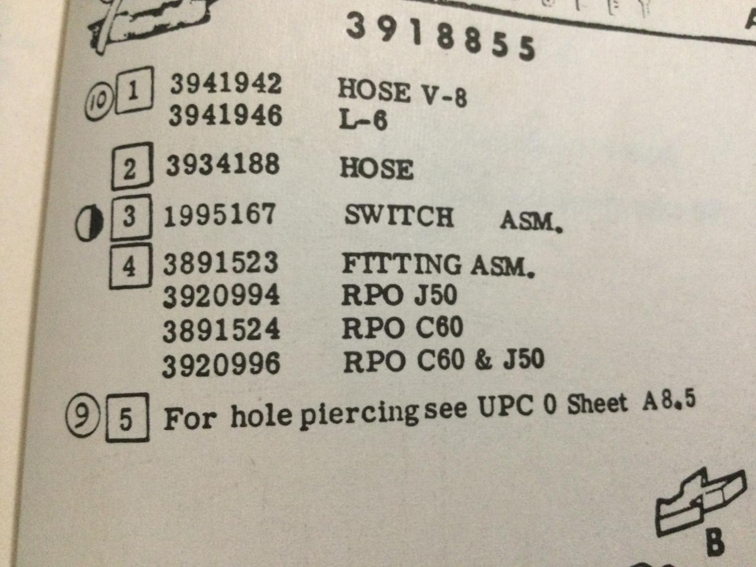

GM wasted a lot of time, money, and effort on stuff like this. Here’s an example that makes me shake my head and ask WTFO? 1968 Camaro Rally Sport option. Look at all the possible vacuum fittings…4 for the inline 6 and 8 different ones for the V8. Would a rubber plug be cheaper? Or a non drilled/filled port?
And here’s another. My car has a 6 cylinder, AC, PS, and an M35, so it gets the 796 alternator, not the 817 as called out in the C60 section in the AIM. THE 817 would be for a manual transmission right? But I also have PS, so it gets the 817 as called out in the AIM in the N40 section for you guessed it—M35. This is where I SMFH because there’s no communication. I digress.
And if anyone has or knows of a 1100817 alternator, please contact me. It’s a 61 amp. Have a great Sunday peeps.

Short answer, the frame brackets offset a BB to the right to clear the steering gear. That interferes with the heater hose connections.
Measured at the rear block surface, a BB is also positioned further forward than a SB.
Since the BB was developed long before Camaro came on the market, it would have been a simple matter to design the chassis to accommodate both engines, using the same parts.
My guess, Chevrolet did not intend to offer it in the Camaro. Fall '66, Ford took some buzz off the new Camaro by offering the 390 in the '67 Mustang. Had to respond.
