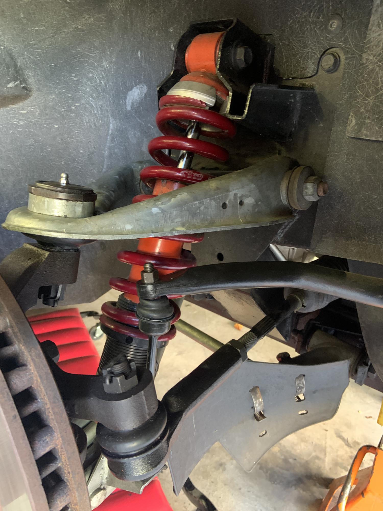

Since she is up on jackstands I am still "mission creeping". I was greasing all the ball joints and tie rod ends when I noticed that all the sway bar link rubber boots have turned to rubble. They were a clear poly material originally and have totally decomposed after 29 years. Don't even get me started on what a new set of sway bar links go for if you could even locate an NOS set of the unique 1992-95 links - try around $300 each!!! And no one makes replacements.
There is some Viper parts place out west that advertises a new set of boots for $200 !!! (The dreaded Viper tax) Seriously guys? You can just measure the flanges and then shop for replacement boots on the net.
Before I started measuring and searching someone recommended I give Tator's Garage a call http://www.tatorsdodge.com/
https://www.youtube.com/watch?v=mJwL...el=LewisboroTV
So I used some ball joint pullers and got the links off today. They were all in perfect shape other than the boots. I was able to make contact with Chuck Tator at Tator's Garage last night. (they were formerly known as Tator's Dodge, est in 1908 and they were the oldest Dodge dealer in the world, when Mopar decided to cancel their franchise during the bloodbath of 2008 when they killed off 1/3 of their dealership franchises because they were not multi-branded.) They were also one of the largest Viper dealers for Dodge back in the day.
I left a message for Chuck and he called me back at 8:30 this morning and said he was mailing out the new set of boots for $40 and needed my address. I then asked if he was ready for my credit card info. He replied: "I don't do credit cards - the bank takes too much money. I just send out the parts and an invoice and you can send me a check when they come in." He even encloses a stamped, self addressed return envelope.

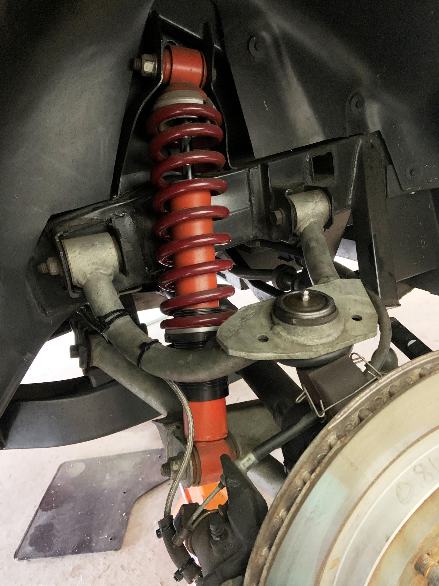

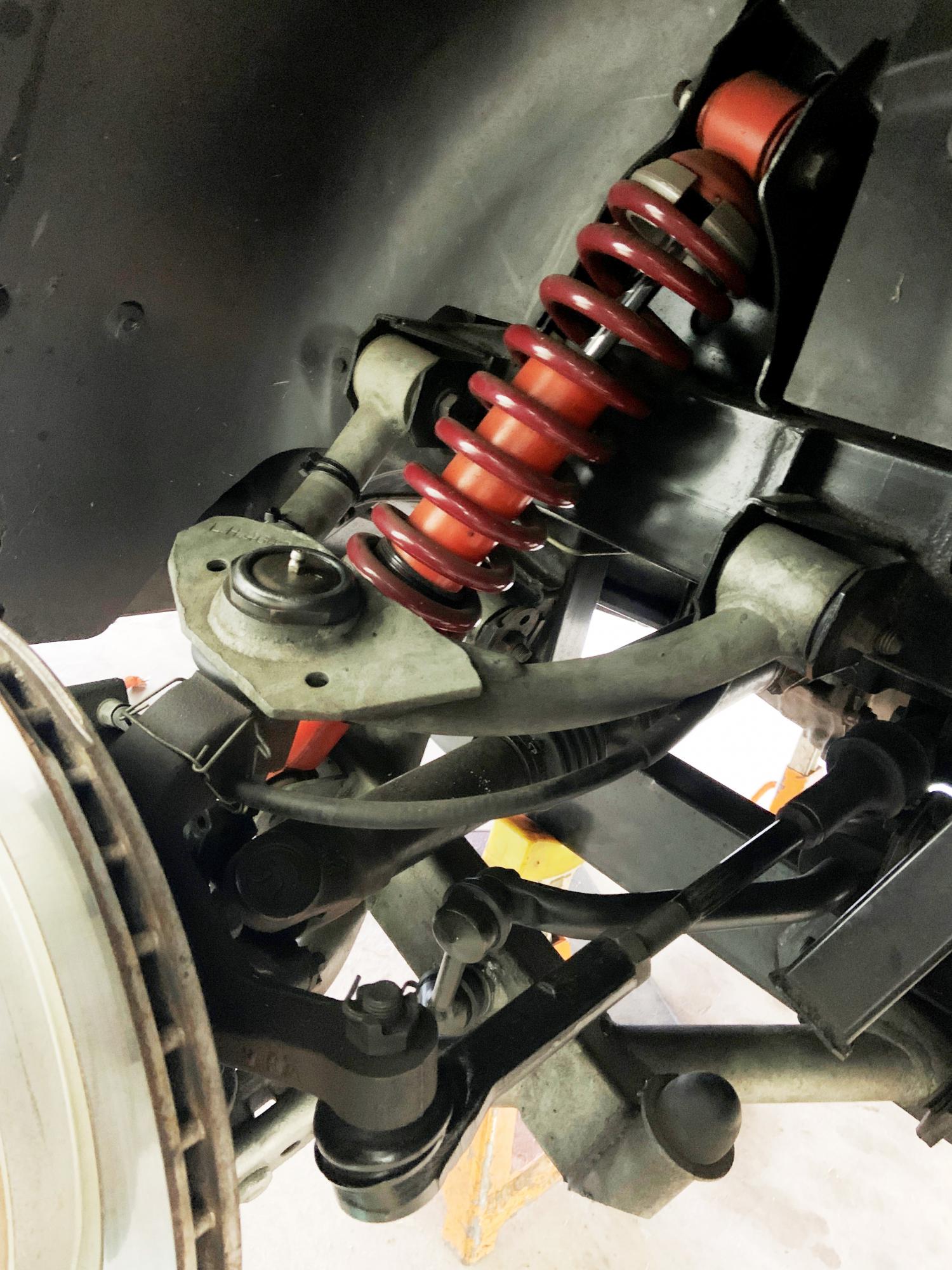

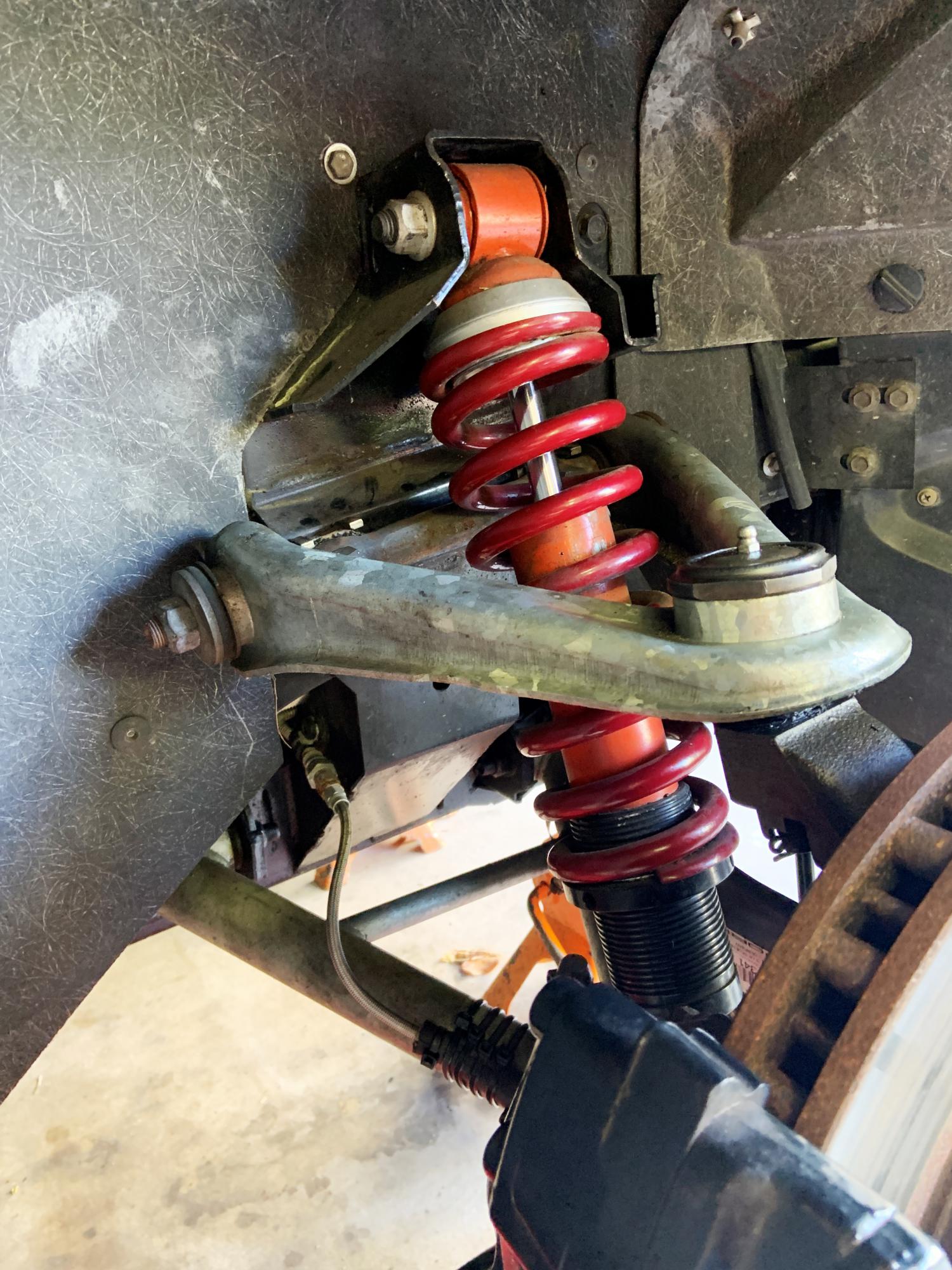

Here's the suspension details. The factory installed, fixed spring, Koni shocks were sent back to Koni in 1993 and they installed the adjustable spring perches for aftermarket Eibach springs.
I have been on the phone with Koni and Eibach this week trying to find the correct spanner wrench for adjusting the spring heights in case I ever want to mess with the settings. Back in the day I uses a 5/16" drill bit inserted into the adjuster hole in order to spin the spring perch. Not too easy with 500 lb rated springs. Neither company makes the wrenches so I had to search to find an old style round tip spanner for a 82mm perch. It should arrive tomorrow. All the modern perches now employ a square adjuster slot and use a flat, hook style wrench.
FYI, In 1996, the Gen 2 suspension replaced everything you see here with forged aluminum control arms, different shock/springs and a totally different articulation geometry that made the car much easier to keep in a straight line and much more forgiving to newbie owners. It was a night and day difference. They also added airbags, roll up windows, and actual door handles on the outside of the car. Simply preposterous, I tell you!
Too cushy for me though. I like the brutality of the belligerent, original, Go-Cartosaurus Rex.

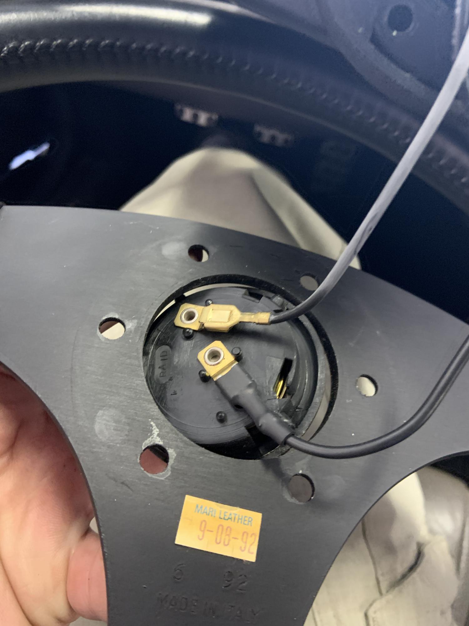

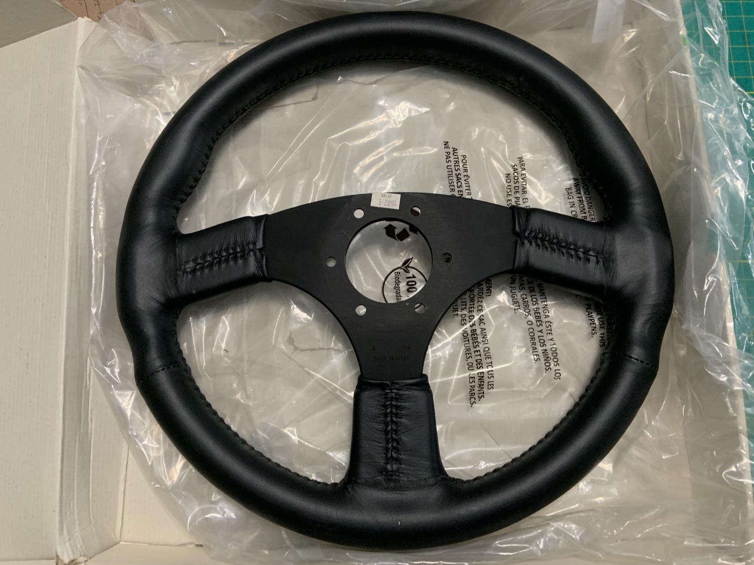

My early birthday present arrived!
An NOS Gen 1 Viper Steering Wheel still in the box. My original one has all sorts of scuffs, nicks, and scratches in the leather from 30 years of abuse. I'll retire the original one up into the storage closet for safe-keeping.
