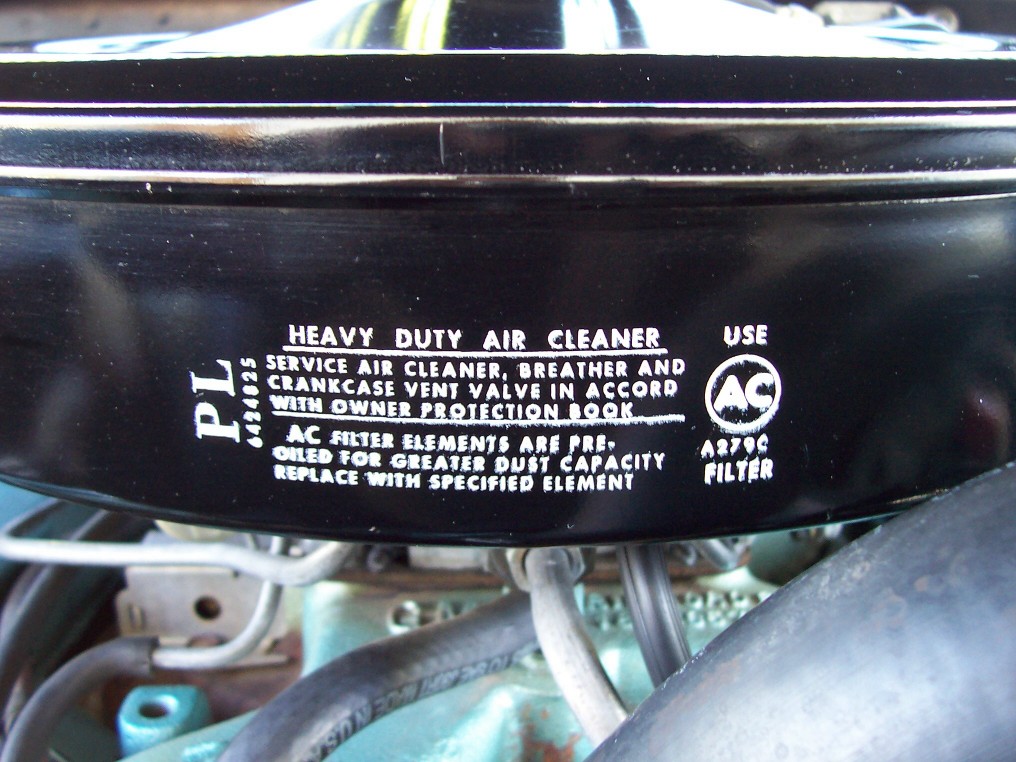

Oh, I see what you're referring to now... UPC code K45, HD Dual Stage Air Cleaner. This was just a heavy duty element with additional oiled foam around the paper element.
Here's a photo of the HD instruction label from one of my old '69 GP's.
