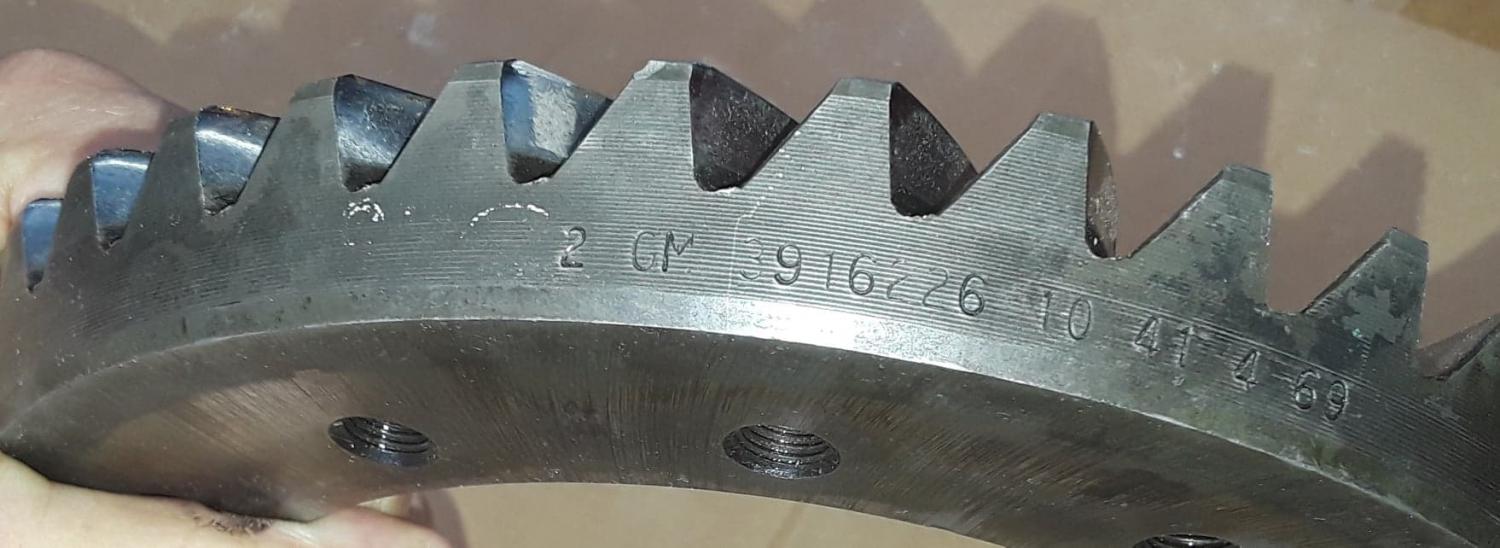

I have a friend that would like to know the value of a matched
set of COPO 4.10 gears. They were pulled from his '69 Z/28 but
did not know exactly what he had. He gave me a call and after
referencing CRG's website I got back to him and told him what
he had. GM part #3916226 (ring) #3916228 (pinion) stamped
on them and dated April, 1969. Yes he is willing to sell them but
does not know the value. Also, being the purist at heart he would
like to see them go back on a real Supercar from that era. I have
tried to upload some photos but it's not allowing me to post them
because of an error. Need help posting these pics....Thanks in
advance.

First question; has he double checked the assy code on the rear axle to make certain it isn't a BE rear?
It is going to be tough to find a BE axle sans gears. Otherwise, they probably end up in a restamped BL axle.
I would guess he could get $2k to $3kfor them, but then I have not had anything like that in years. I believe the last set I sold was for $1,200, but that was many years ago.
Guys with COPO cars would know way better than I.

Any purist guy wants the piece of mind that he has real parts. I have discussed this same idea at the Camaro Nationals. It is a way to set good cars apart from great cars. I am sure these are a matched set. But to help from people questioning them...pay the $50 and get them magged and give the buyer the receipt. $1,900 is your value. The reason they don’t bring more money is because your buyer pool is very small. So many guys don’t care.

Here's some pics of the gears...I managed to meet up with
him today and it seems that these gears are in pretty good
condition. Lynn, I did mention to him to double & triple check
the rear code on the housing--just to make sure he doesn't
have a BE rear as opposed to a BU rear under his Z/28.
