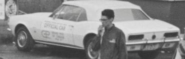

The big dealer for the MOSPORT cars:

Just out of curiosity, were the Canadian pace cars also white with blue stripes and interior?
Old 02-09-2021, 12:04 AM
Zedder's Avatar
Zedder Zedder is offline
Join Date: Sep 2002
Location: Ontario, Canada
Posts: 3,330
Thanks: 100
Yes, Lynn. I owned one of the small block RS cars when I was 17 years old!
