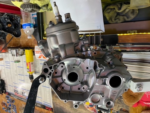

Has anyone used vapor blasting to clean aluminum parts like intake manifolds and valve covers.
