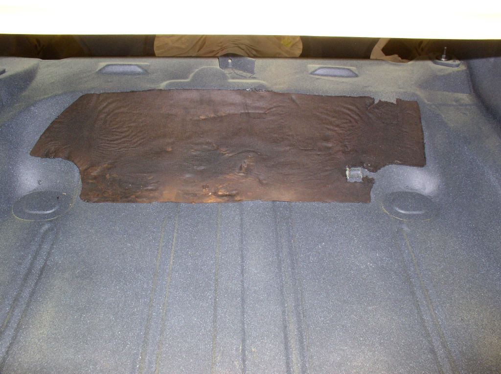

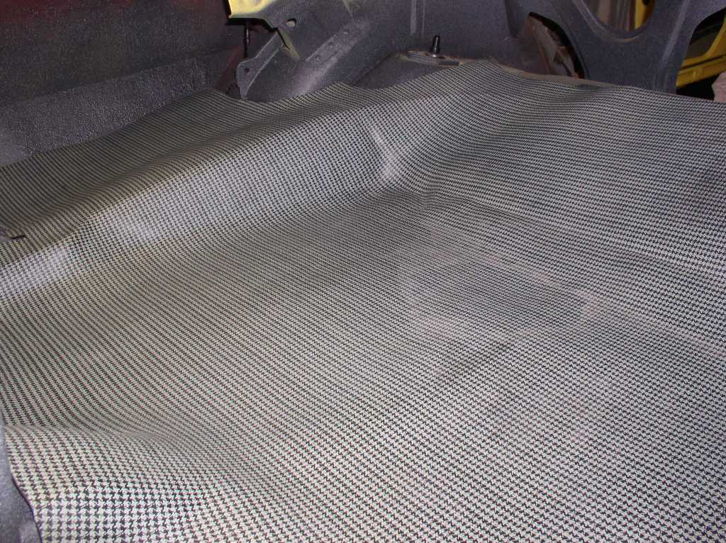

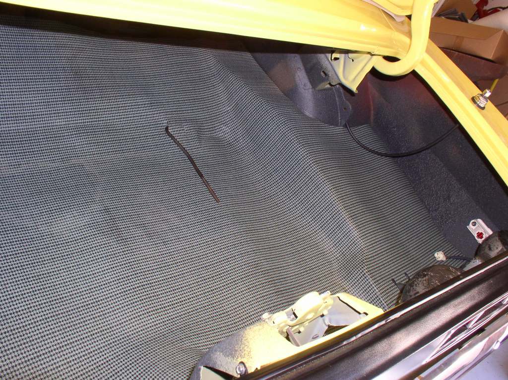

Finally got one the items for the car, the melt pad for the trunk. One of our members here was nice enough the send me one he had laying around. Warmed it & the NOS trunk mat up out in the sun for a while & then installed them. Trunk mat was also purchased from one of our members. What a great group of people. One more piece of the puzzle....Joe
