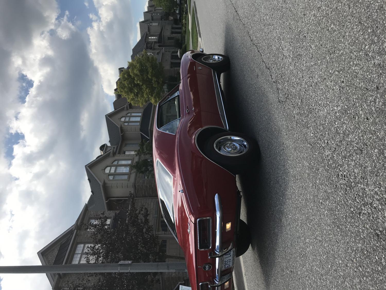

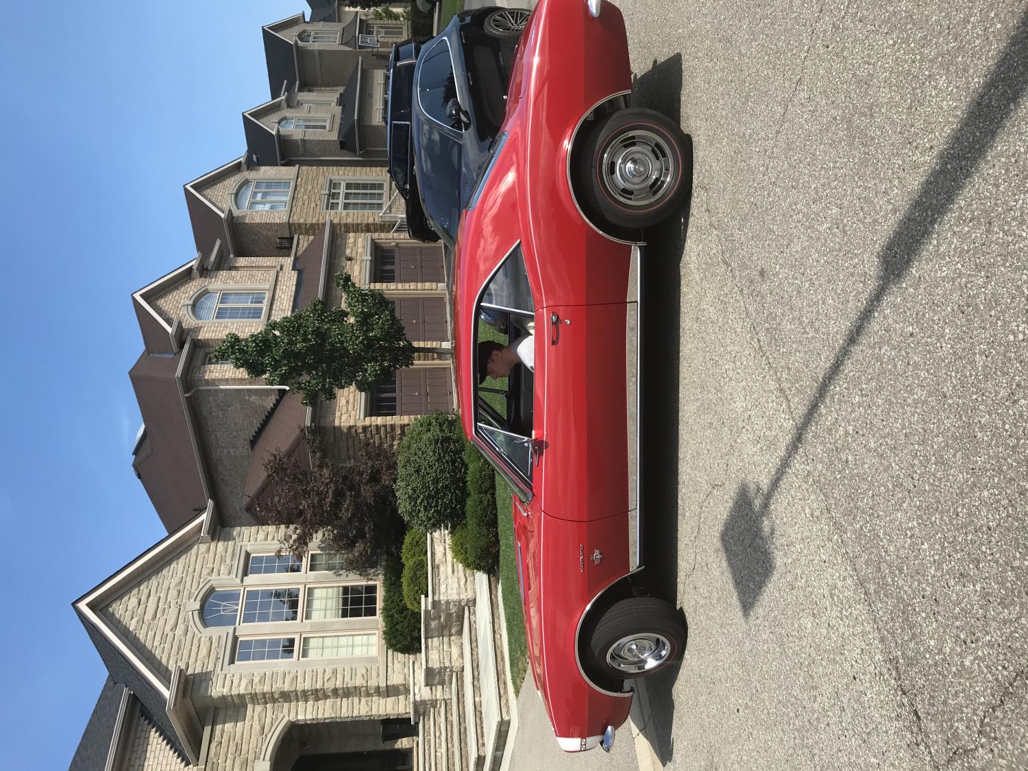

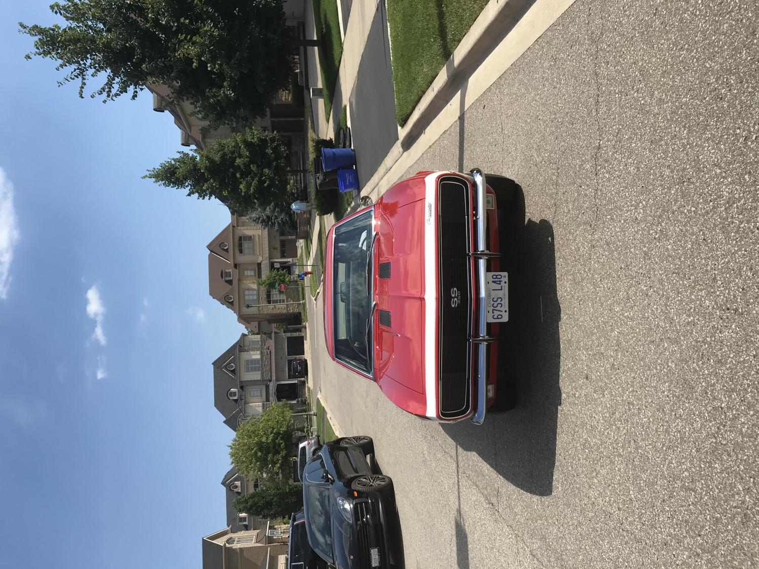

Sorry for the sideways pics...that drives me nuts!

Can you post pics 90-D out so they land here correct?
Bummer about the core.
