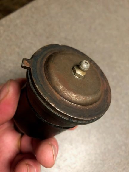

Can someone post pics of the lower ball joint with tab as opposed to the replacement ball joint?

Here is an NOS assembly line correct 70 Camaro lower ball joint with the tab for reference
Steve Nuwer
www.2ndGenZ.com
