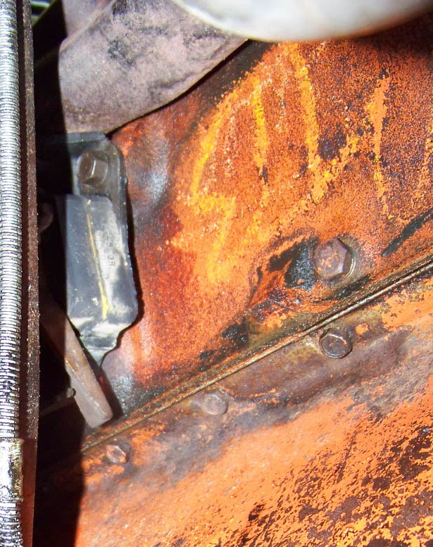

69 Camaro RS sat in body shop for several years, untouched. It was a magnate for dust though, like the hood was up the entire time.
I am going to replace the hoses, clamps, plug wires with restoration pieces for maintenance and safety.
What are some safe ideas for overall cleaning of the compartment? I am not pulling the engine, but not afraid to use crevice tools.
Thanks.
