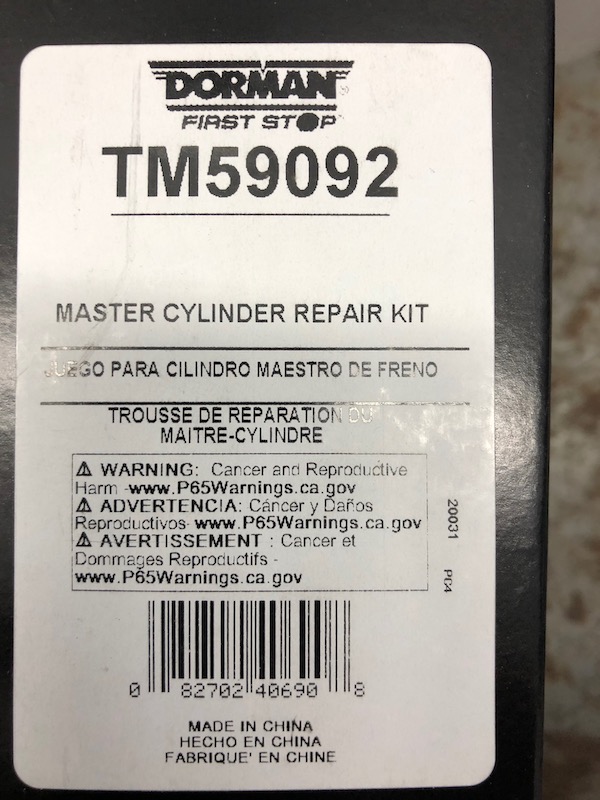

Some time back I sent two '67 Chevelle SA code 346 masters to White Post to sleeve for future use.
A year and a half ago installed and bled the first, pedal bleeds-by to floor. Used master works good. Ordered two rebuild kits from Inline Tube, first kit installed, no better. Second kit installed, same.
Ordered two DORMAN kits (remember, I have two White Post masters) from RockAuto (label attached), first kit installed, problem solved!
More recently, different car, installed the second White Post master as delivered, pedal bleeds-by to floor. Installed the second DORMAN kit, problem solved!
So, it wasn't a sleeve problem, rather the rebuild parts kits. Now I have four brand new master kits on the bench that don't work!
Related issue, driver's side, four piston caliper on second car, three (3) times to and from LoneStar, leaked in a different place each time. Last time back, no leaks, all good now.
