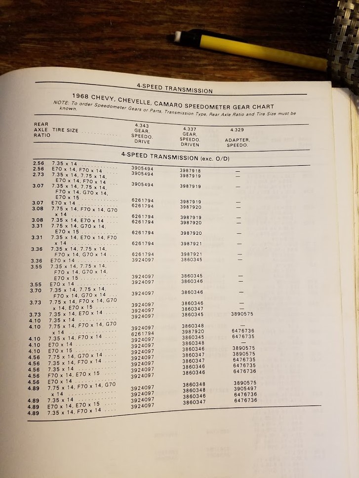

Did the Copo's and Z/28's with 15 inch tires use a reducer with 4:10 gears?
