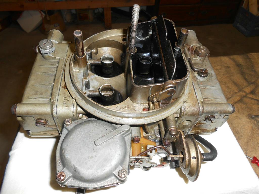

I thought you guys may be interested in seeing this and giving your opinion. Does anyone see many similarities between these 2 carbs?
https://www.ebay.com/itm/274003013751
https://www.ebay.com/itm/193159609461
The expensive carb is for sale by Buddy Hill, a known scammer. For those not familiar with Buddy Hill, you can learn more here:
https://www.yenko.net/forum/showthread.php?t=140881
Any opinions on the 2 carbs? I think they are one and the same.

same carb, practice makes perfect, you restamp enuff parts over the years you get good at it

Not too smart though. That carb should not have dc stamped into it if hes going for authenticity.

Good point Chuck.

Very good detective work. Lot of similarities from the used & abused marks over the years. But mostly you can faintly see the three below the four and the zero turned into five does not match the other five's. Appreciate the heads up. I hope your work saves someone.

That shadow “3” stuck right out to me...clear as day, and I don’t even know these carburetors well!

The shadow 3 is what tipped me off too Dave. Then I remembered seeing the service dated one that had sold. It really sucks and I hope if there is anyone out there trying to make a case against this guy than this will help. Buddy Hill, YOU SUCK!
