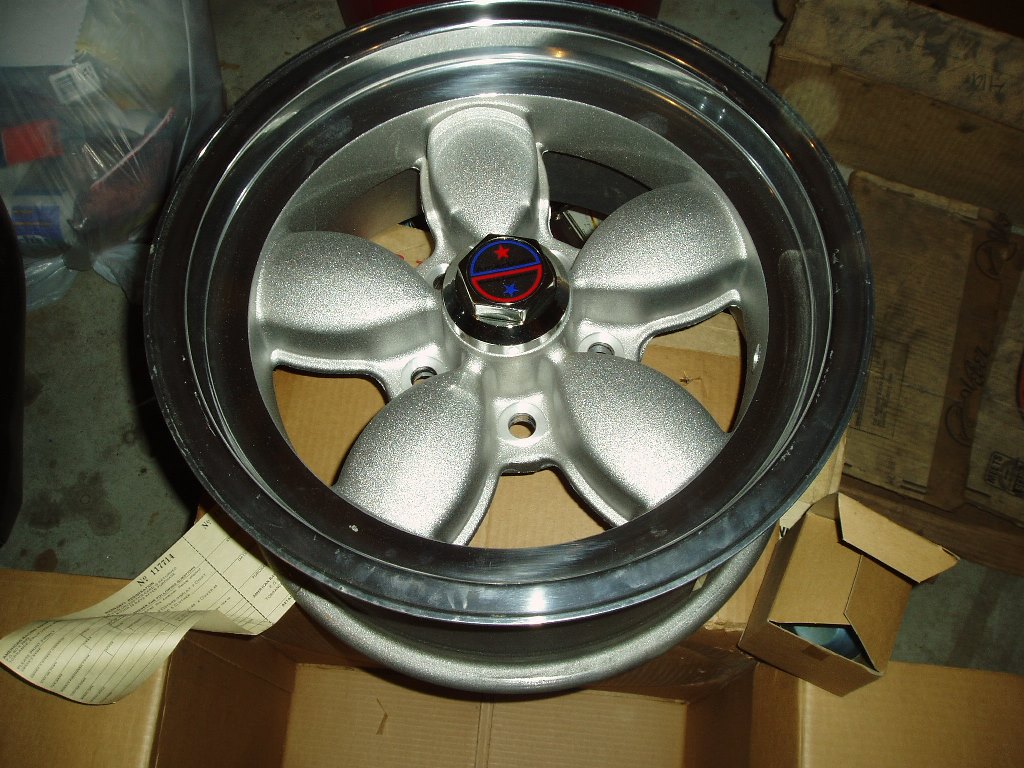

The NOS pair I found were pristine cast aluminum - like a brand new intake manifold. Here's a photo of the NOS rim just out of the box.
Best bet is to have them media blasted with the plastic or walnut shell media (tape off the polished outer rim when you do it). That's what I did with my set in the link above.
