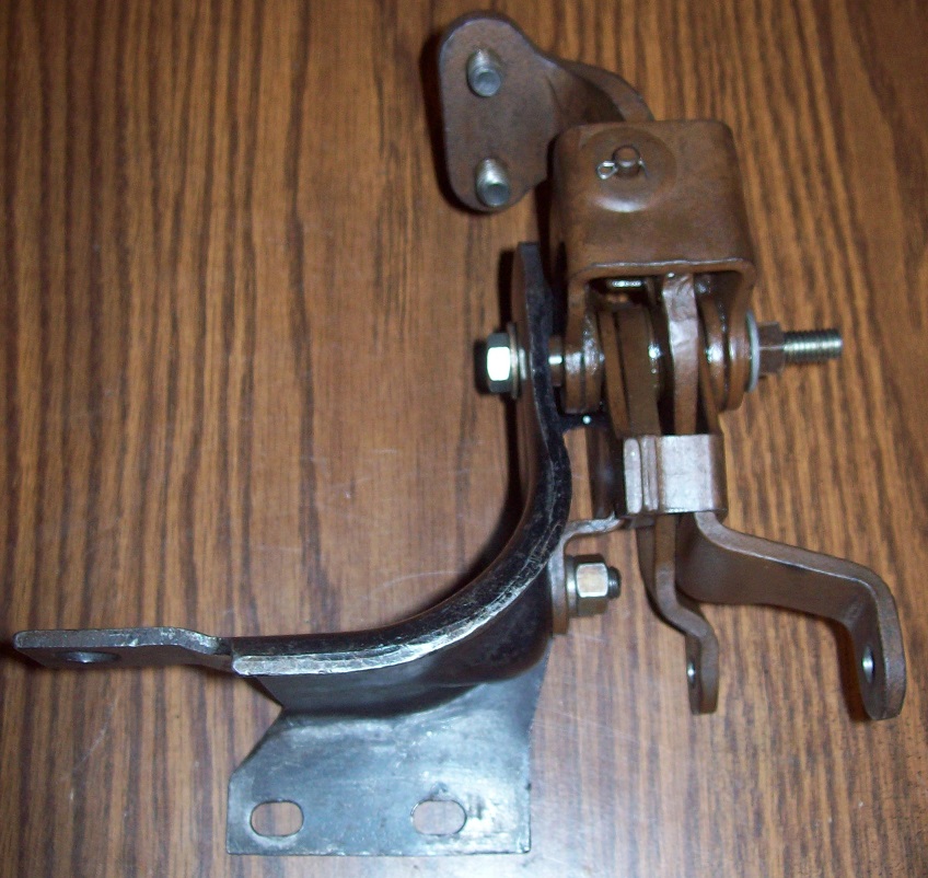

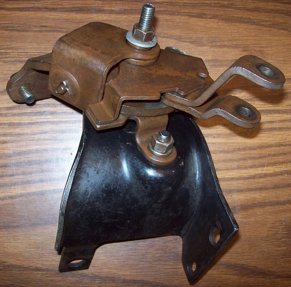

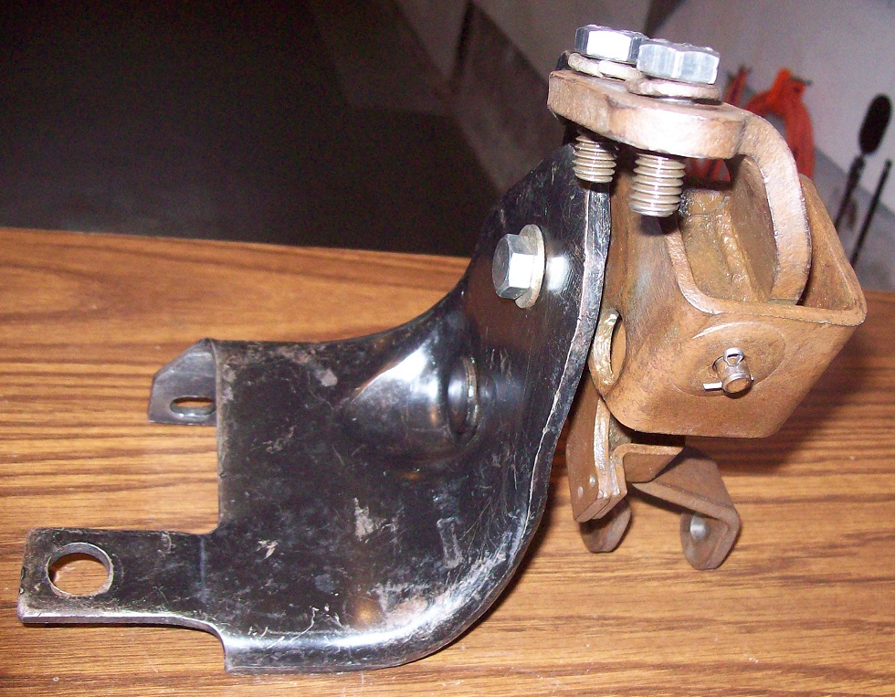

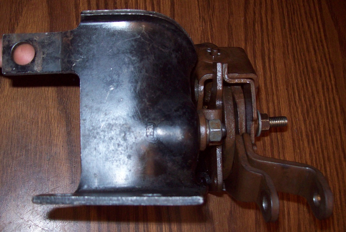

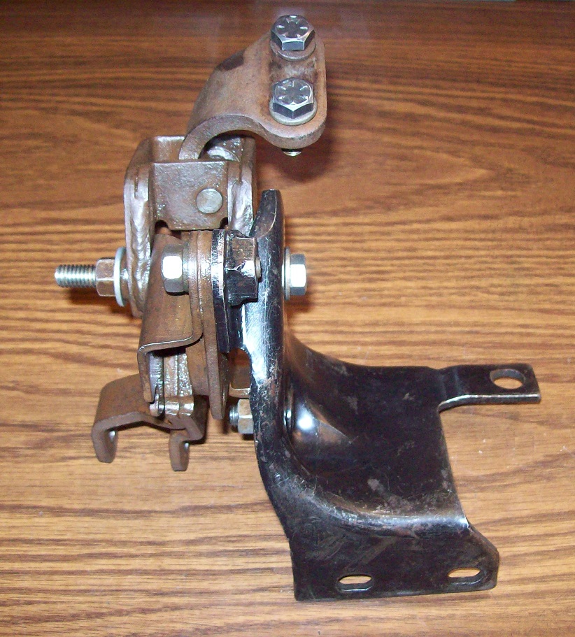

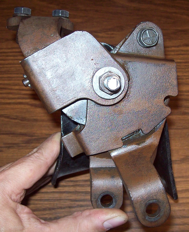

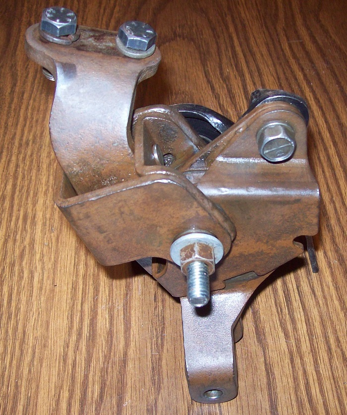

Rare HD Three Speed Muncie Shifter assembly With Cross member Bracket.
In Excellent condition with no issues, shifts like it should. I took everything apart for a very good clean up and re lubricated the unit to make sure it shifts smoothly.
I bought this from a member here stating it was a 4 speed Muncie assembly but when I got it in the mail I noticed it was in fact a 3 speed Unit. Member was very nice enough to give me a partial refund so all is good. This shifter assembly can be converted back to a 4 speed assembly simply by taking the thick Delete plate off and putting a correct third lever if you like but I can't find one anywhere so up for sale it goes at a very fair price.

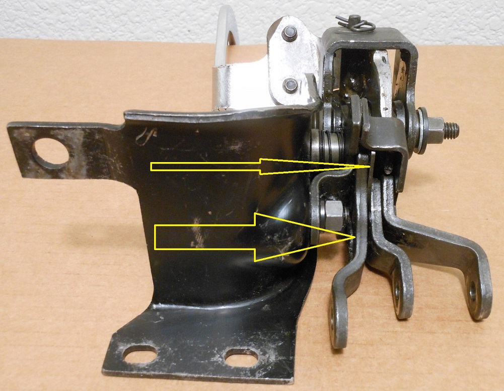

I got lucky meeting Bruce Through eBay over at Manchester Muncies in Iowa and I Ordered a third Shifter Lever and a slide plate to convert this unit over to a 4 speed Shifter by taking out the 3 speed thick delete plate as after talking to him he told me it is very easy to convert a 3 speed unit to a 4 speed unit by simply taking away the delete plate and adding a lever and shim.
Going to keep this for my own car now.

I have the same one what parts do i need to change

You simply remove the Delete Thick plate and replace it with the Third Lever that faces the Bracket and you also need to insert a shim in between the two levers in that center area.
I'll add a photo so you better understand.
