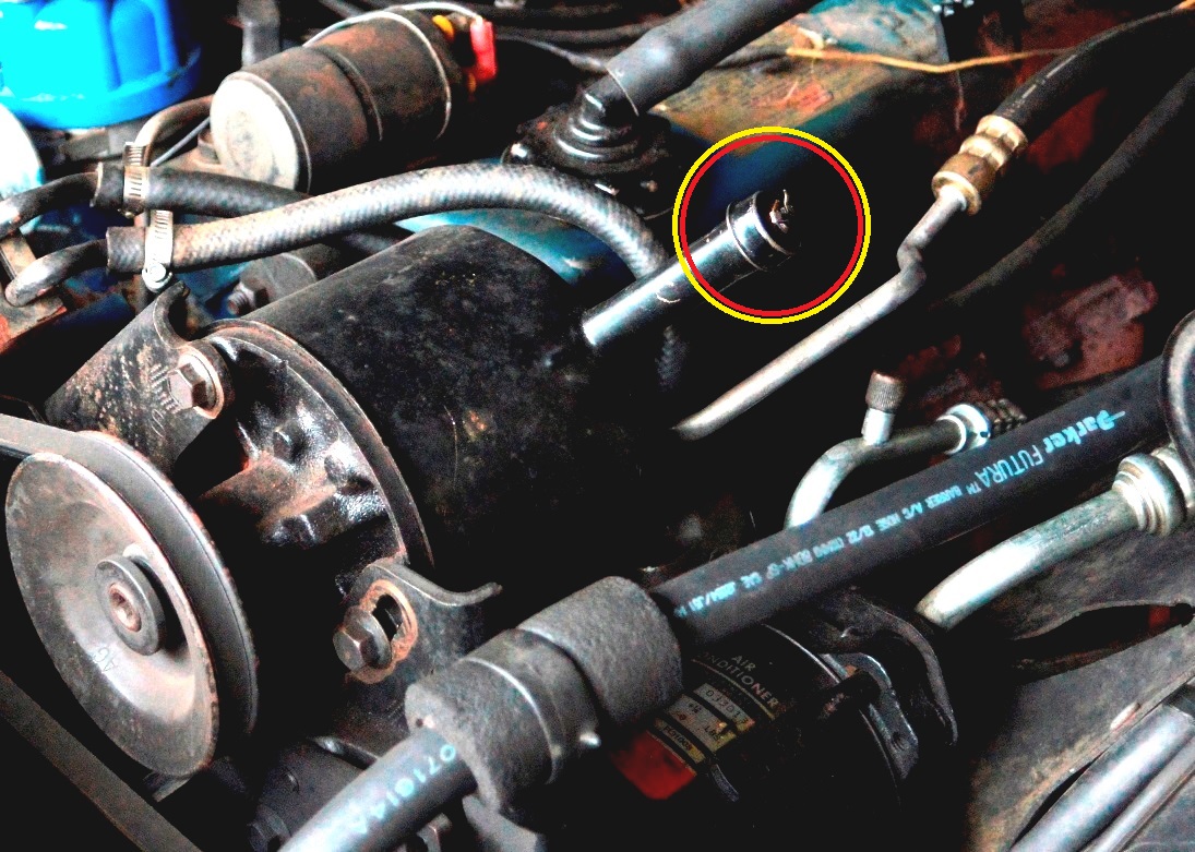

I got the dogfood and went to drive to my buddy's garage to tell him about the shift glitch. We discover that the vacuum line to the transmission modulator was not connected. That seemed like a totally logical reason for the weird shift incident. I thank him and go to leave. I put it in reverse and back up a few feet and then shift to drive.....nothing happens. No first gear, no second gear, no third gear. No forward movement at all. I was like the shifter linkage fell off only I still had park, reverse, and neutral. So Al, my mechanic buddy declared my transmission DOA and I called AAA to tow it home. Luckily I was only 6 miles away and they flatbedded to my driveway and I was able to back it into its space in the garage.

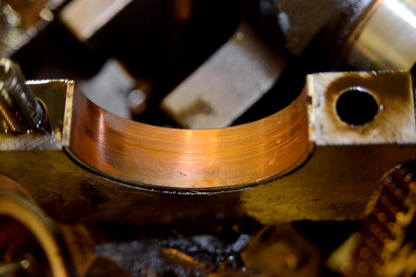

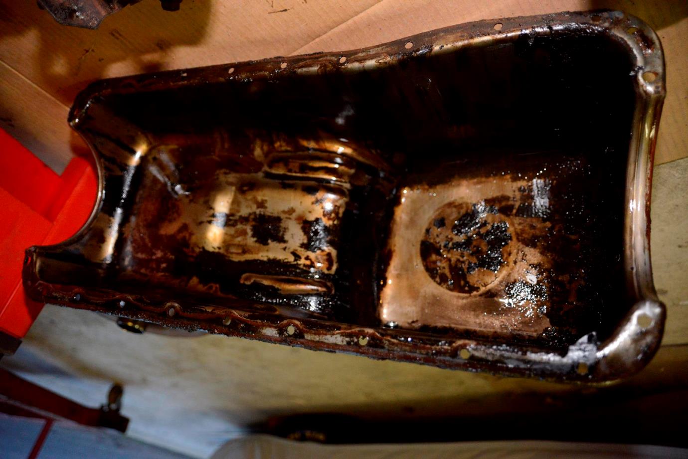

Since the engine was already warmed up, I pulled an oil sample and I'll send it out for analysis just to see what it says. Once I get the engine out and on the stand I'll pull the pan and check the main and rod bearings. I don't plan on touching the short block other than maybe a new oil pump, rear main seal, and gaskets. I will most likely pull the heads and get a valve job and new valve seals installed. Maybe new valve springs if they don't meet spec.

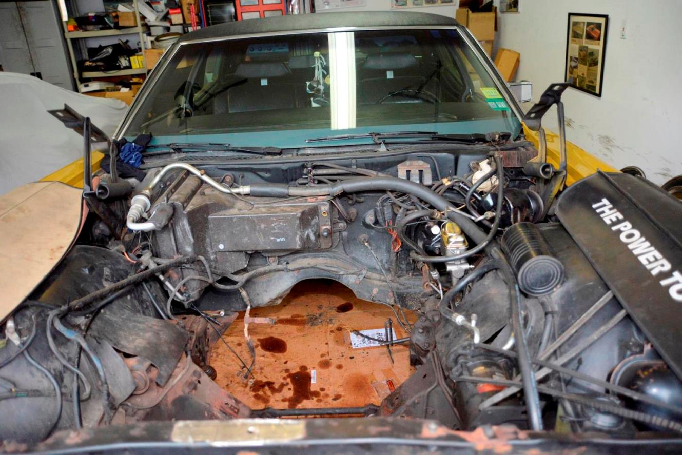

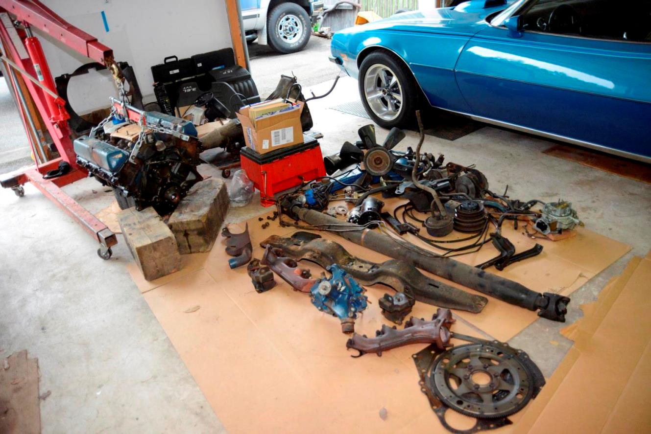

Spent the weekend unbolting everything and removing the engine and transmission. I now realize why the factory manual recommends removing the engine by itself and the transmission later. This has to be the world's longest transmission! The adjustable leveling engine lifting saddle really came in handy as I had to pull it at a diagonal to get it to clear the nose since the entire front end rose about a 10 inches in the air once the weight of the engine was taken off the frame. I then had to pull the front tires and lower the body to the ground on two floor jacks just to get the assembly to clear the nose. Did it all by myself, with the wife and son only assisting during the final maneuvering over the front sheetmetal when someone had to hold up the trans yoke to clear the final hurdle while the hoist was pulled forward.
