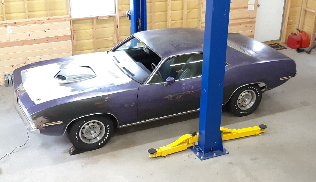

Welp, like everything else automotively planned, it all went up in smoke. Coincidentally, I did receive another text from Phil!
So right now I can't figure out what the deal is and why it won't stay running more than a few minutes, then not start after it dies, so it's best to just walk away in disgust.....yet again.
I was ready to back her out and go for her maiden voyage on my birthday, but that'll have to wait until later on this month. By the time I get back I'll have the glass installed and she'll be done! That is, if I can ever get her running more than a few minutes.
She sure looks good though!
Cheers
Dave
