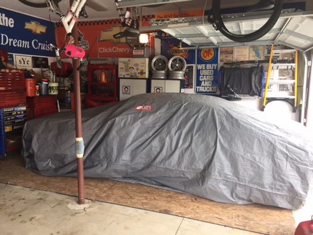

To all,
Just wondering what everyone is doing to winterize and store there cars. Not sure if any one use's damprid and dryer sheets, or not recommended? I have my car in my heated garage with a exhaust fan I run here and there. Air movement is important but im wondering everyones set-up. In regards to carbs/fuel storage any specific recommendations?
thank you in advance!
